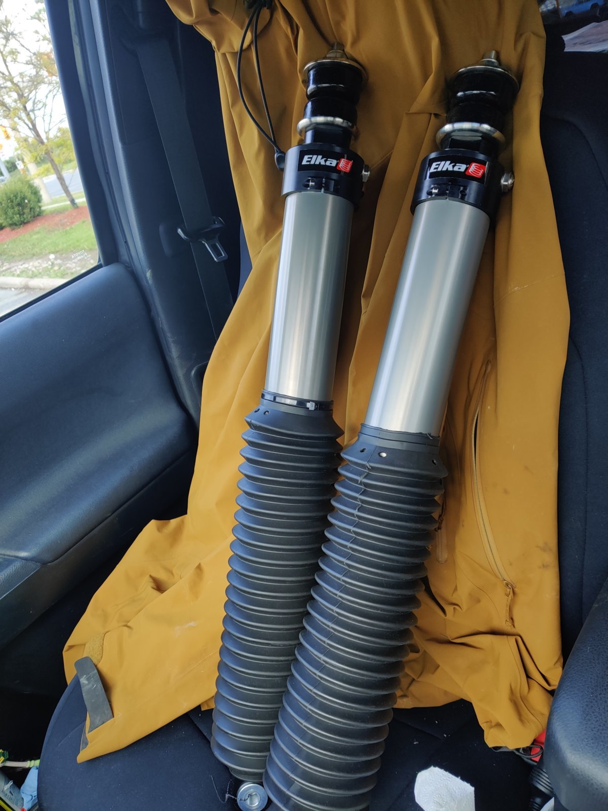

    These are comically large lol

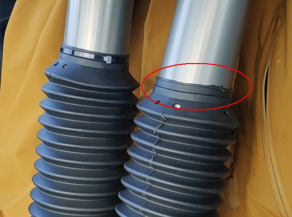

    Looks like Elka cheated you out of a zip-tie!

    3, actually. Bottoms weren't zipped either

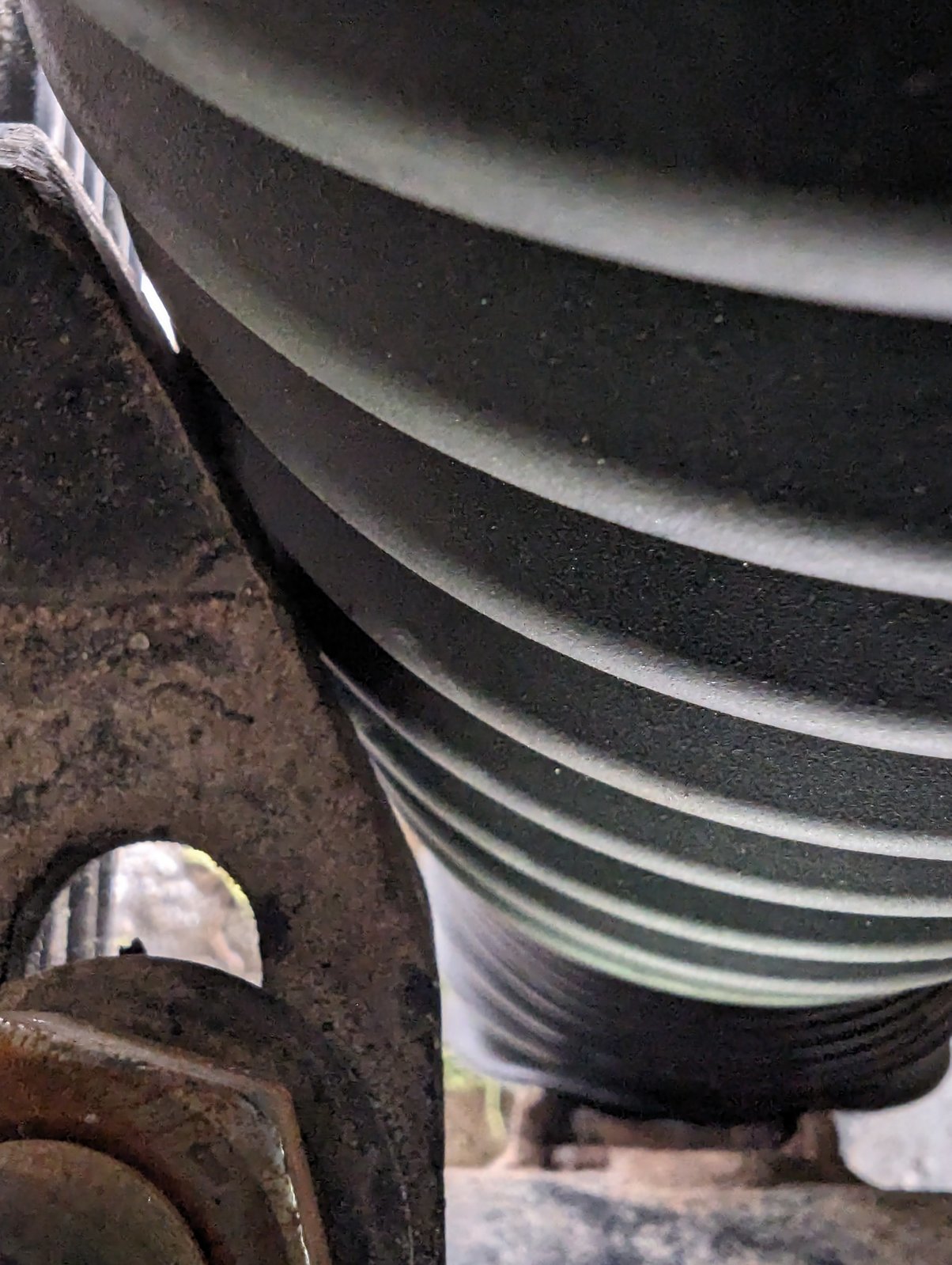

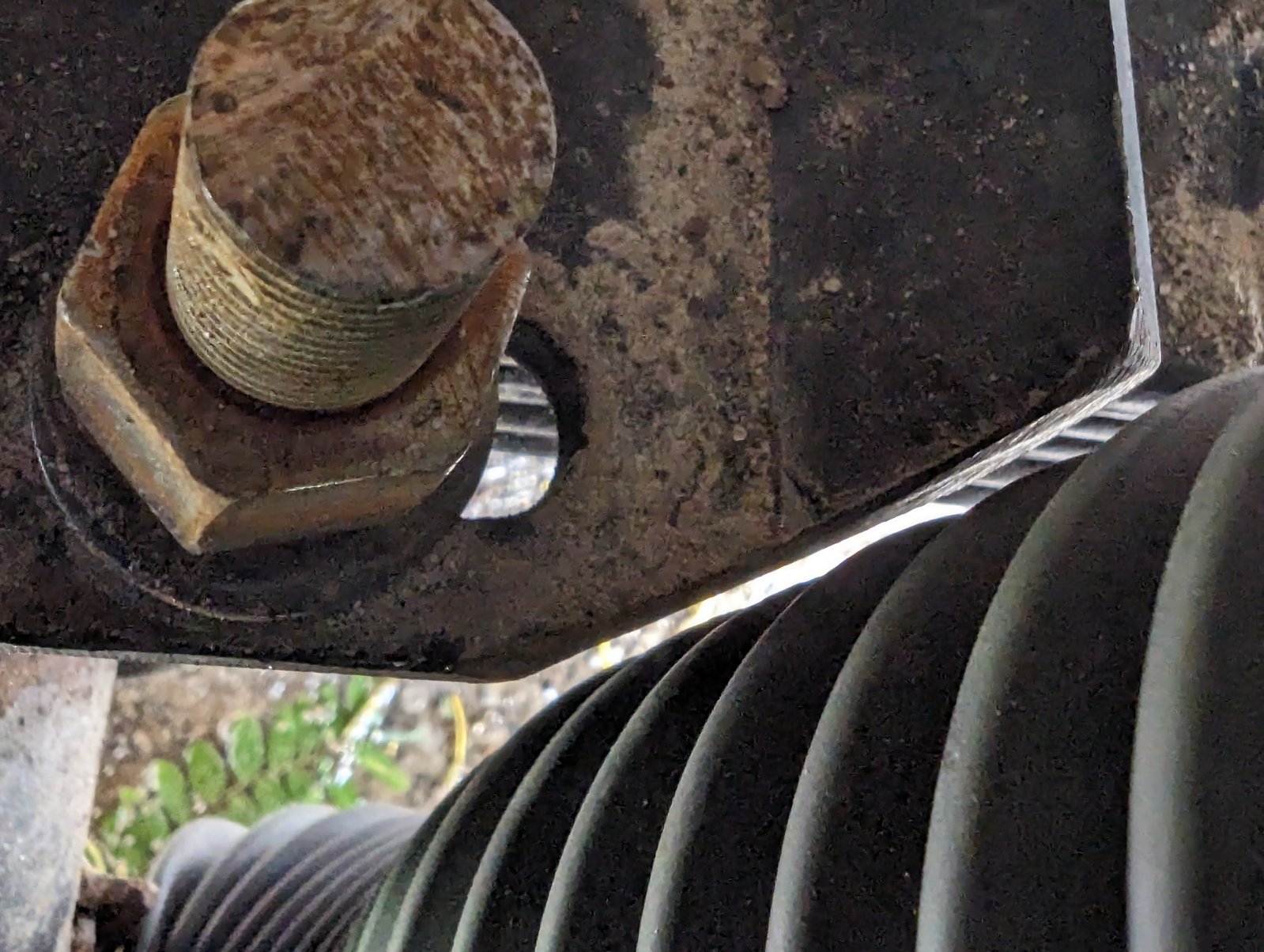

    Should I be worried about this clearance?
    Shock boot as it sits
    Tight against shock body
    Actual shock body distance

    Elka advertises "induction-hardened shaft" i.e. no chrome plating to chip. It may be better to run without the boot, as long you keep fluids like Cosmoline or Fluid Film away from the exposed shaft.

    I'm more concerned about contact with the body than the boot. Not sure if anything twists while cycling

    ^Looks like there's about 1/2" clearance between the U-bolt plate and the shock body (for visual perspective, the U-bolt is either 9/16" or 5/8" dia.), so you're probably fine.
