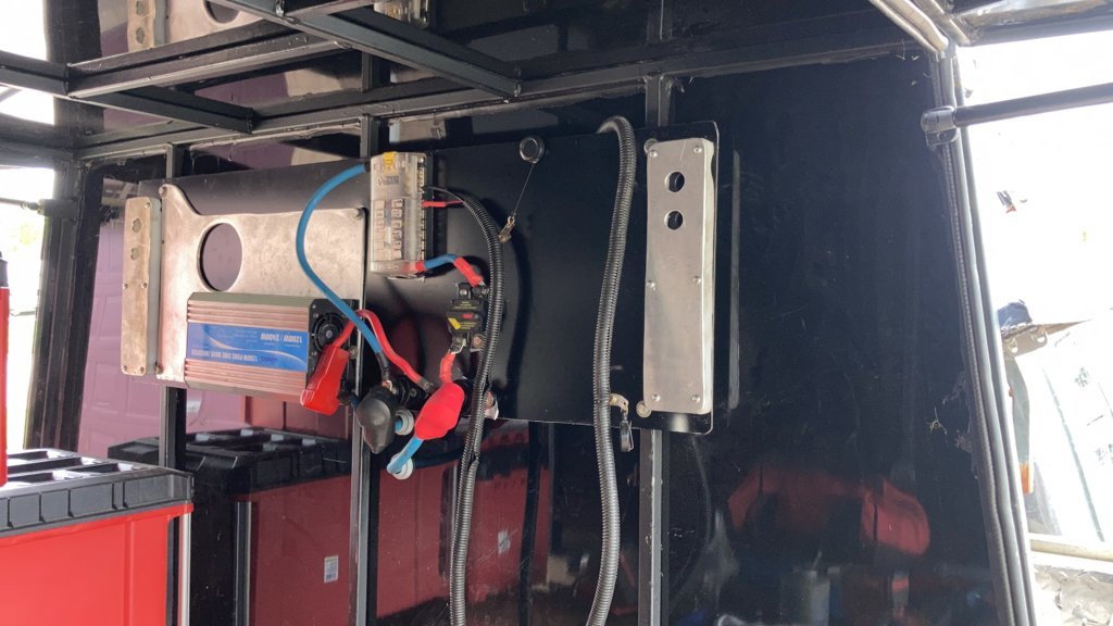

    I’m running a 1500/2400 watt for charging drill batteries and any other things needed.
    this is the back and I have 1/0 run to it.
    blackgen2tacoma and FastEddy59 like this.

    Looks good. Yeah, that’s about as big as I’d want to run. I’ll be using it for the same purpose. Batteries.
    tacoma16[QUOTED][OP] likes this.

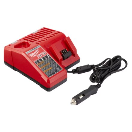

    consider using a DC charger for more efficient charging as it eliminates the loss related to the 2 inverters you have in line.

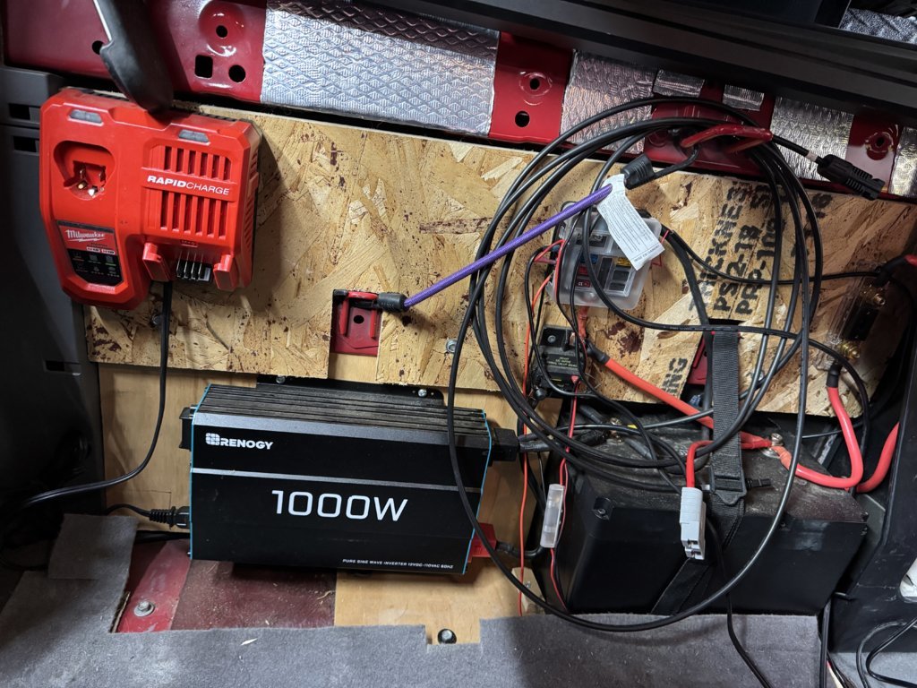

    And related to the topic Heres my 12V setup.
    I didn't want to connect the 1000w inverter to the original 120v harness because the wires were very thin gauge.
    12v 100Ah battery
    1000W inverter
    Renogy 50A dc-dc
    I avoided the DC battery charger because its $160 and charges slower.
