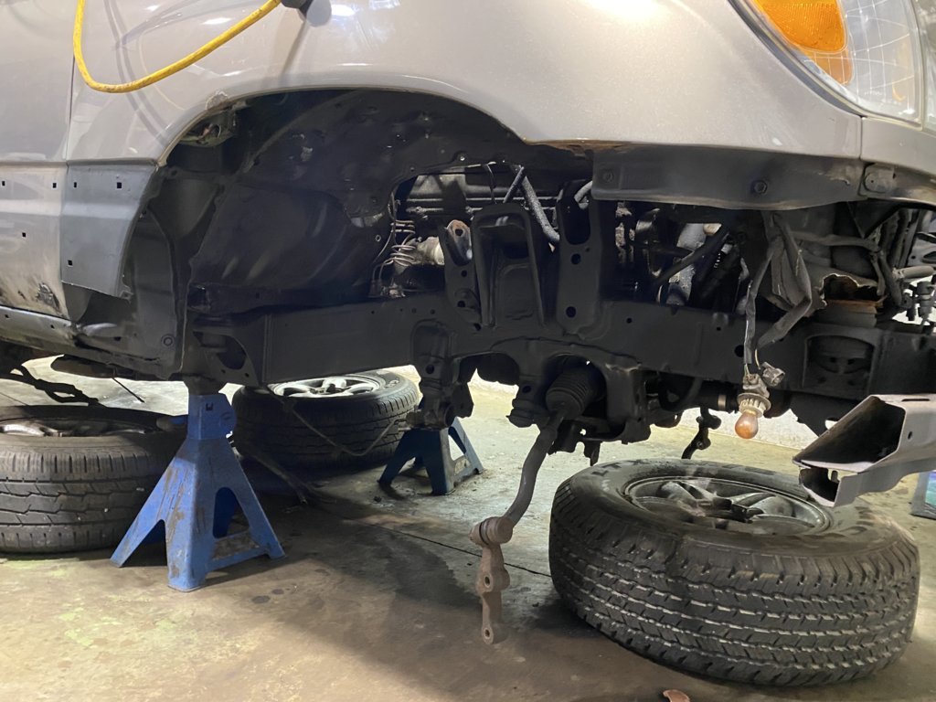

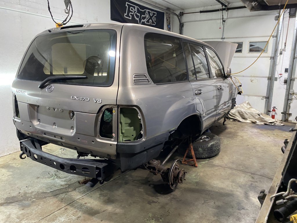

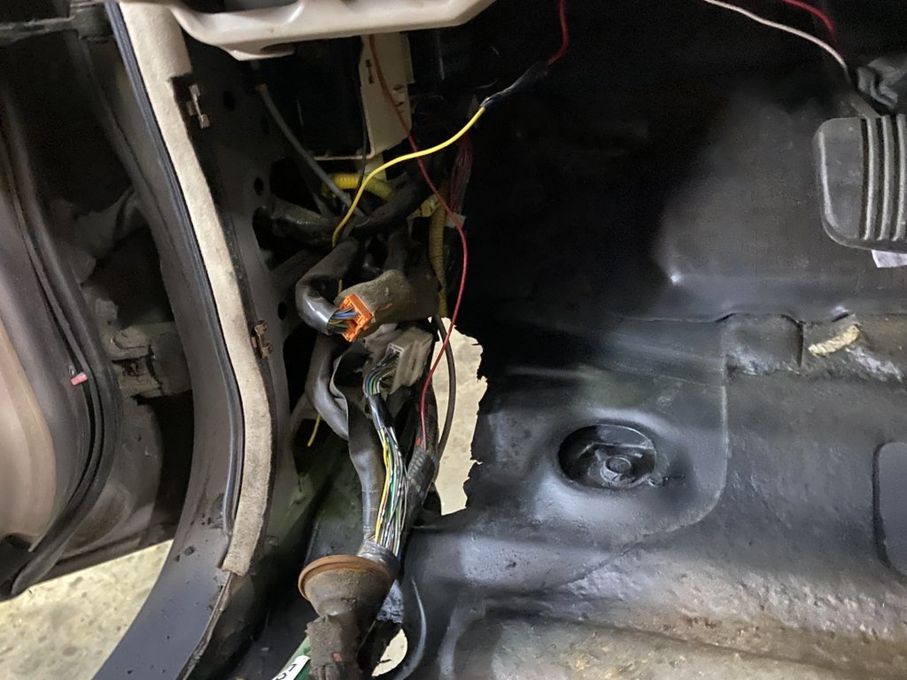

    Some progress, as much as I would like to weld I am going to go with automotive adhesive that are used to glue modern vehicles to save on prep/time for floor repairs. The rust spots also self cleared for tubbing… I guess that’s a win?

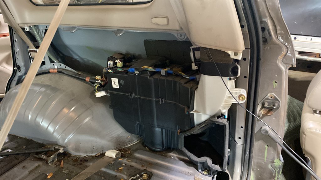

    Fun fact, this is how rear passenger floor heater operates in the ancient cruiser.
    And this is evaporator for rear AC which has its own duct system independent from the front.

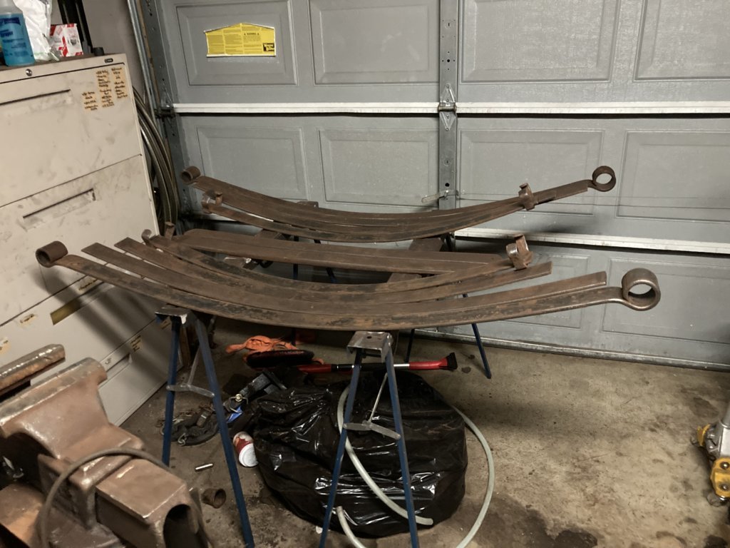

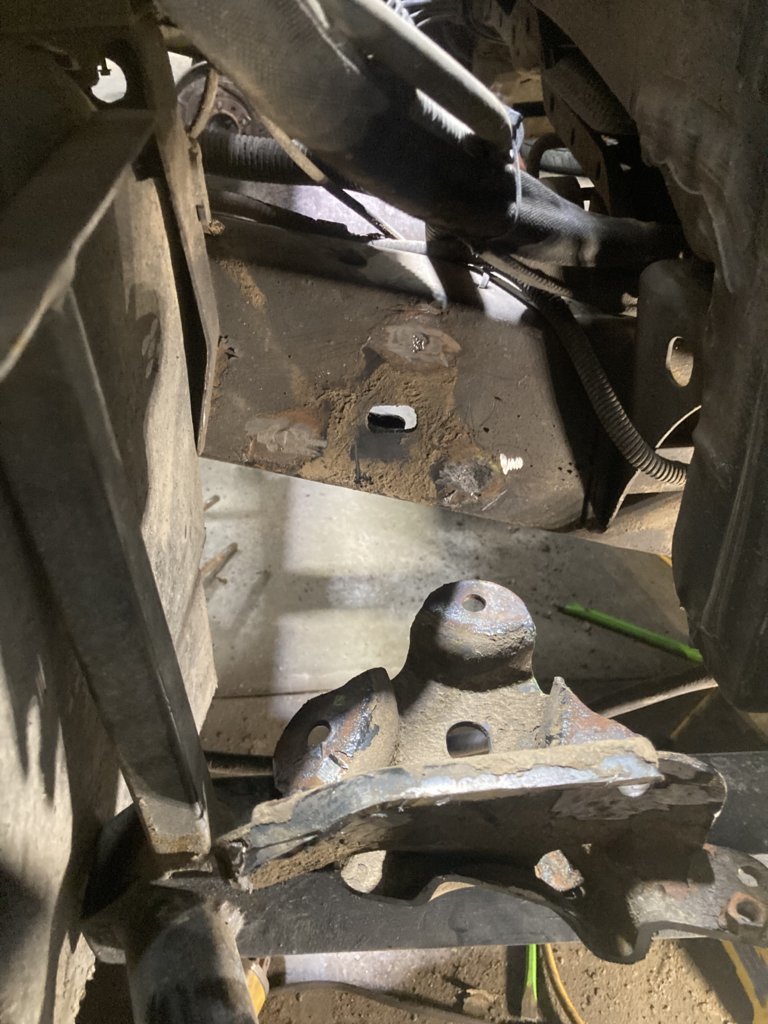

    It’s not much but it’s honest work
    Leafs spring mounts cut off the frame.
    “New” springs getting cleaned up for a layer of paint. Have new energy bushings for these. Going with the 4+1 leafs out of a 2010 Chevy 2500hd. IMG_0427.jpg

    I was too chicken to cut mine off. I can't believe you just cut your off leaf spring mounts.
    What did you use to cut them off?
    :eek:
