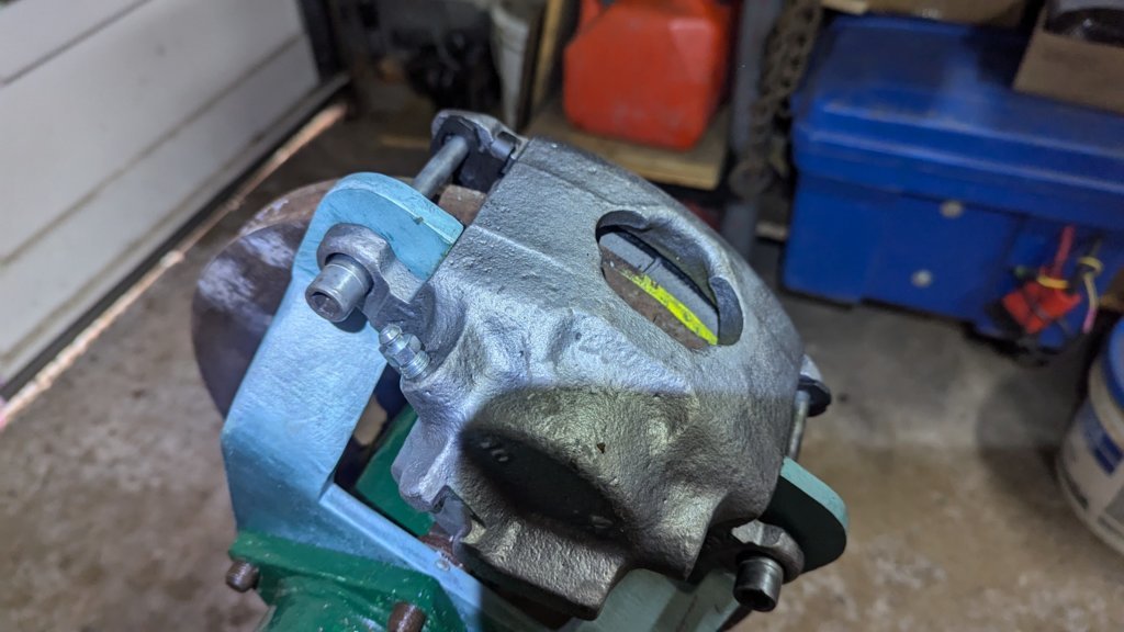

    just for fun anyone got any ideas as to why this is happening.. I'm going to adjust the pad material but maybe someone knows why its happening.. inside pads are ok there just at the edge, acceptable.

    What is the problem here?

    The outter pad sits over the rotor outter edge the yellow paint is the edge surface of the rotor

    By how much?

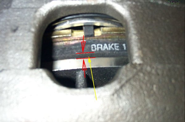

    The caliper may not be sitting square. Apply some shop air to the caliper hose port to extend the piston and put a squeeze on the rotor, then observe.
    The holes on the caliper bracket may be drilled too high. Also happened to the author in this guide here: http://www.billavista.com/tech/Articles/14-Bolt_Disc_Brake_Conversion/index.html (single rear wheel hub shown)

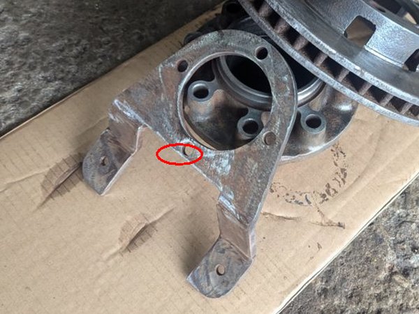

    Do you know which vendor made the disc conversion kit on your axle? Was the caliper bracket home-made? I see a thin-walled area that would have an outgrowth on name-brand kits:

    1/4 inch

    Honestly it's been too long I don't remember where I got these from.
    Il do the shop air tomorrow.

    As far as I can tell can tell the pads are squeezing flush with the rotor. Decided to just knock off some pad material at the top. All good now

    The pad overreaching the rotor does no harm. The opposite is worse, as the rotor would develop a rust lip around the outer perimeter. Had this happen with Centric rotors and pads on my father's Subaru.
