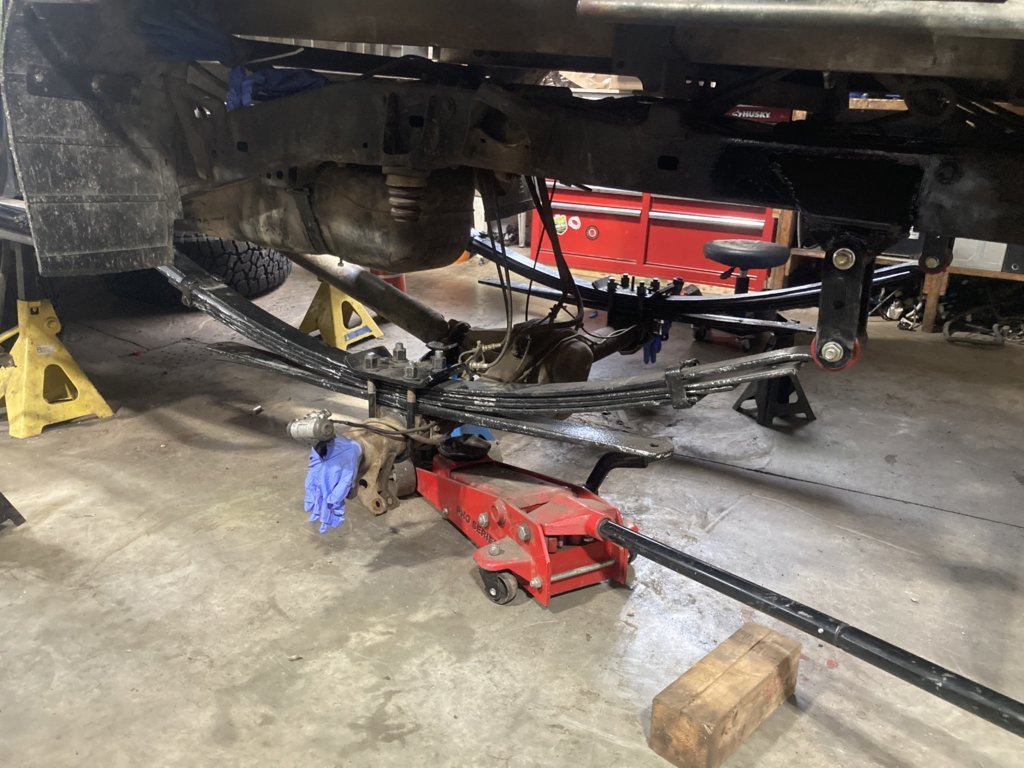

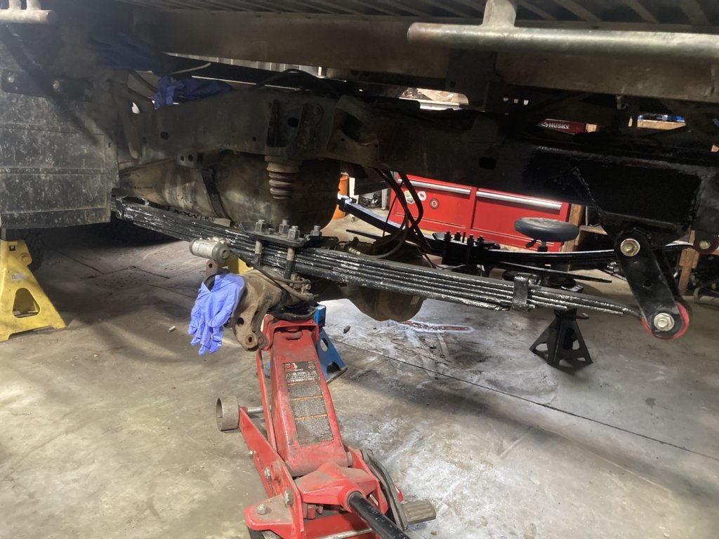

    Getting closer. Just have to figure out some bump stop plates.
    looking at 34-35” drooped and 20-21” bumped with what I could do with the jack. 14” travel shocks should fit but have to do some playing around with towers.
    Just need to bleed the brakes, fill up the diff and re connect the filler neck and she can be sitting on its wheels again.

    I'll have to double check but I think the last I checked I was at 13 or 14 inches of rear wheel travel from right at the bump. Stop to full droop. If you're saying you have 35 in of travel man that's amazing

    I’m only looking at 14-16” of rear travel. I was taking some measurements of total length while in full droop and total length while full bunp. Really depends on shock tower placement but 14-16”. My b110 shocks that I had which are 10” are going to be limiting. So that’s a win.

    Leafs haven’t gone into negative arch yet so should be able to get some more out of them. But issue is going to be 35’s and flatbed rubbing lol

    Nope that can't be right as the shocks on there now have 8" of travel. Getting old...

    I wonder if spring under would give you more travel with the flatbed. Anyway for what we do you have alot of travel.

    just to have a bit more down travel and more readily available parts. Can go get a 2500 Chevy pack from anywhere. Mind you the old man emu pack has been on the truck for atleast 12 years. Will continue to serve @Trdtacosauce when he gets them in.

    Stock IFS front suspension has 8" of travel. Rear should have more. Basic Fox 2.0 stock replacement rear shock has 9.1" of travel:
