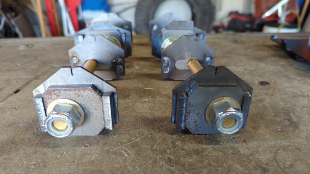

    Finally addressing the bison tabs that i wasn’t happy with at the time of install.
    Found its kind of interesting that both aftermarket cam delete options (that I’m aware of) are both a full 2mm smaller than the OEM
    OEM
    Bison
    Taco tabs
    These are for the front LCA mount, the rear is similar.
    so the Front LCA is in direct relation to your tie rods so if they move within the 2mm of the slop it will knock your toe out
    Cam pulled all the way out within setting #4
    Toe measurement
    Cam pushed all the way in on setting #4
    Toe measurement
    TMR toe plate takes the measurement 10” from centre
    so 1/16 of measured movement is about .36° of toe movement on one side
    I had an issue with my steering being knocked back and forth on a road trip so a heads up to anyone else with these kits that your alignment can still be knocked out with these kits.

    It was happening to me too. Did the total chaos.cam gussets and 333 fab cam replacement and never had a problem ever since.

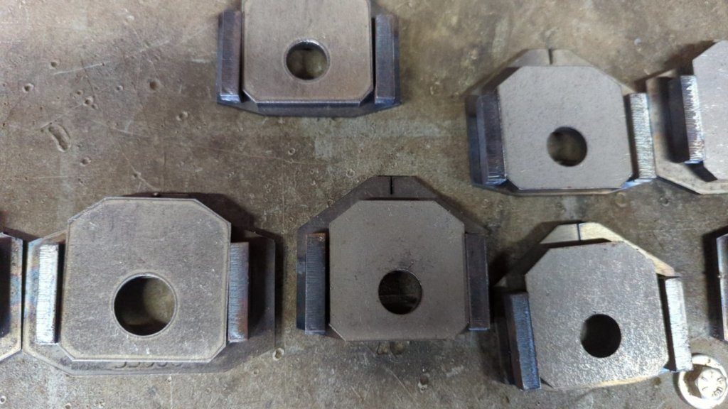

    hear is a pic of before times and another of the 333 fab cam tabs. as you can see they all need special attension when welding them up. you have to squeeze them togeather then weld them up so there a tight fit.

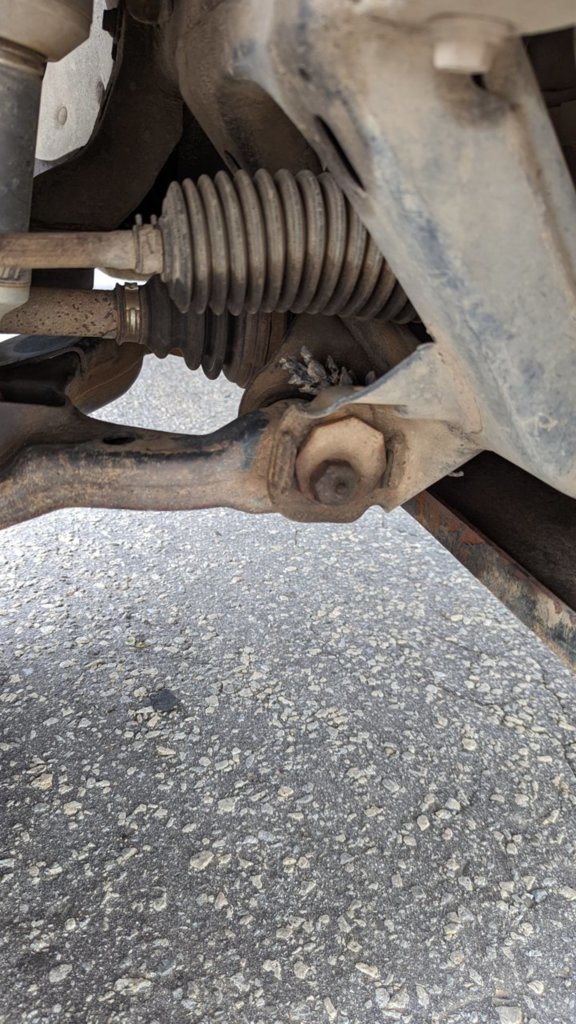

    Doesn't look egregious. You can stick a GoPro pointed at the carrier bearing while you drive at speeds where vibration occurs.
