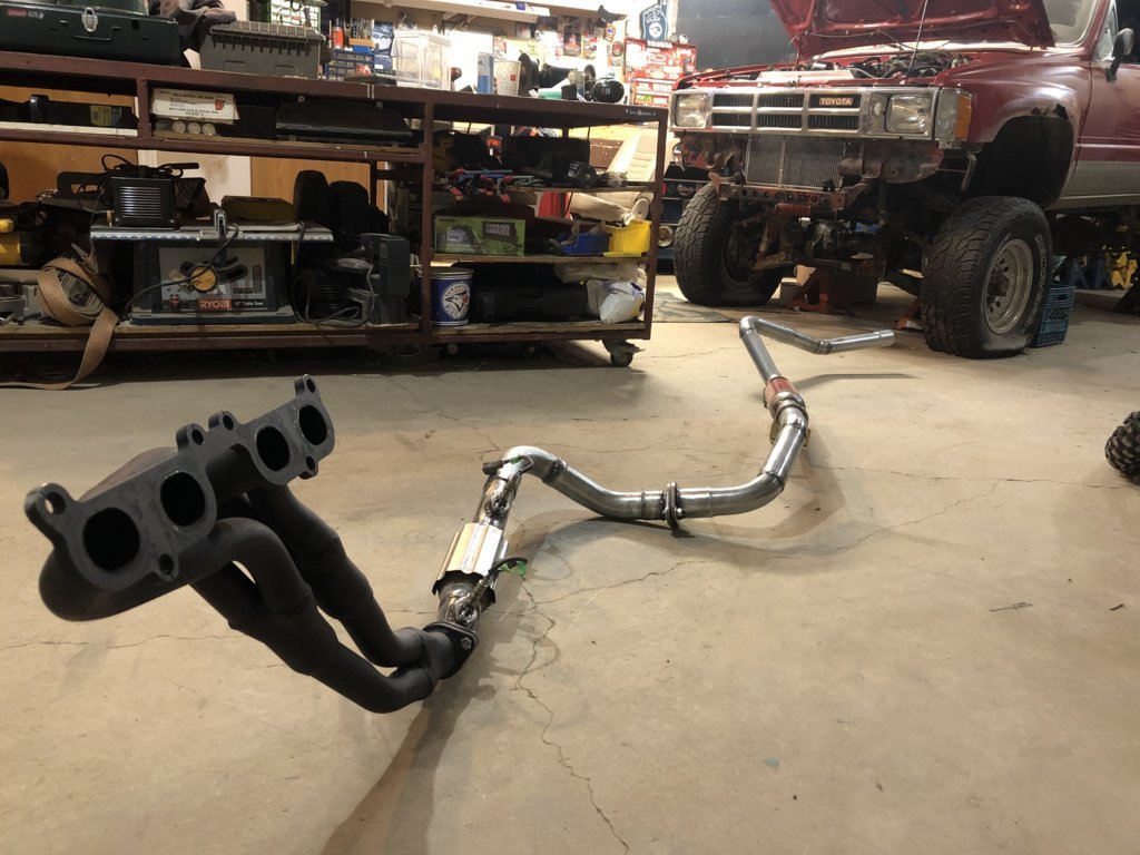

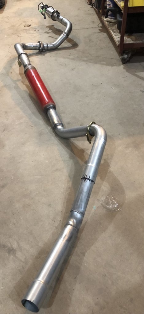

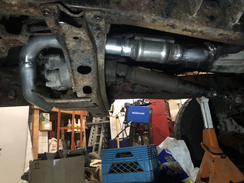

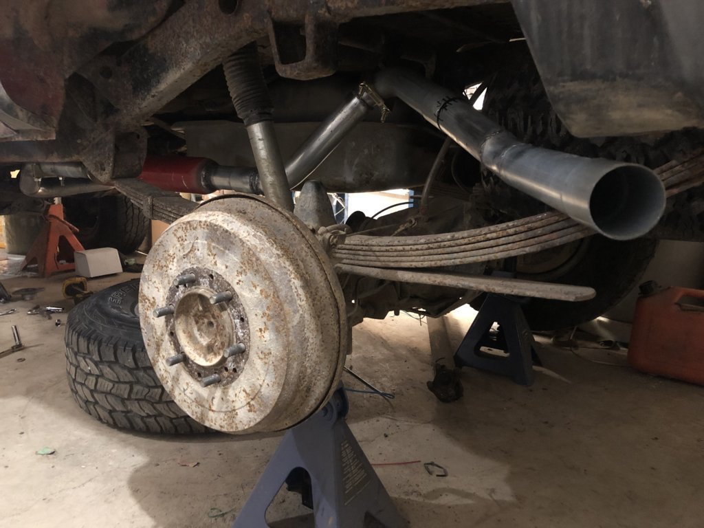

    Spent my Easter weekend fabricating a custom exhaust for my 3RZ swap. Surprised myself at the rate of progress, was essentially completed in 3 late nights.
    2.25" DOM pipe, catalytic converter, both O2 sensors, one union flange, and a cherry bomb glass pack I cut off a scrap truck 15 years ago. Only concern I have is on that cherry bomb, only time will tell if I replace it with something chambered to cut decibels. Gotta protect the little ears in my family.
    Quick vid from saturday night. I couldn't run the motor too long with the proximity of the exhaust to the tcase, floor, brake lines, & fuel lines....but fiberglass wrap and adhesive backed heat shield are sitting on the bench soon to go on.
    https://youtu.be/Uq676rDkgG0
    Had a buddy lay down a couple coats of BBQ Paint to slow down the rate of surface rusting.
    Up next, fiberglass wrapping of the Tri-Y header, and catalytic pipe to the 2-bolt flange union after the T-case.
