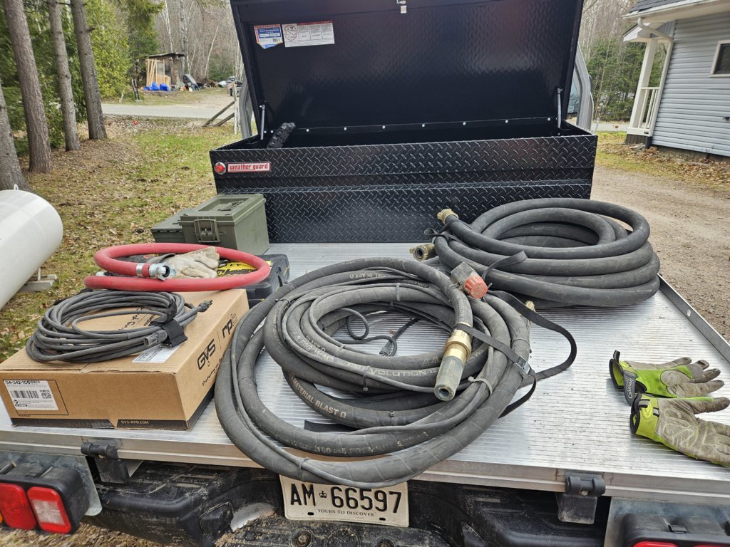

    Boys I know the size of the bed box I have is way to big.
    I have to fit all the things in it, and it does it nicely. All this and more.

    You’ll make it work. Side boxes would help so you can get a skid in front of the axle but those side boxes are pricey and it’s a pain to go back and forth. Side to side.

    From what I could tell, side boxes wouldn't fit the hoses.
    They don't really 'conform' to any shape, other than rolled. So they take up a large amount of space.

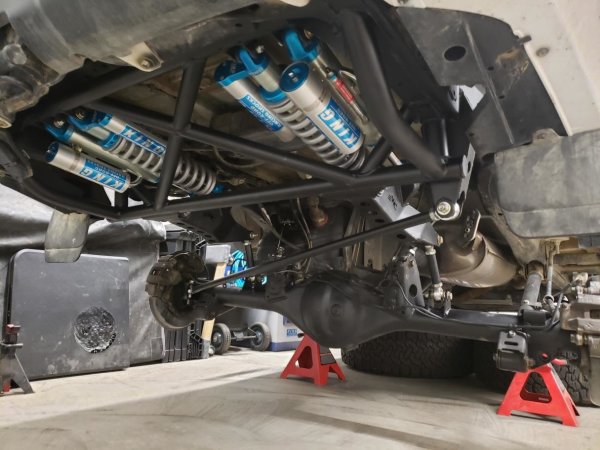

    I was considering using the space for shocks and maybe a fuel tank down the road

    ^Going cantilever? Should be able to tuck the shocks much higher than the 4Runner application:

    Haha. I am just still figuring out shock mounting spots. Was thinking to inboard them kinda like /\ this. Drawer wouldn’t work.

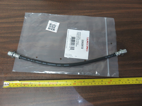

    For anyone doing a mid-travel setup in the front, a low-priced option for extended brake lines is to use 2nd gen Tundra rear left brake lines, for example Sunsong 2202672 or Raybestos P/N BH383032: https://partsavatar.ca/raybestos-rear-brake-hose-bh383032
    At 14.6" long, it's 3" longer than the stock Tacoma front brake line.
