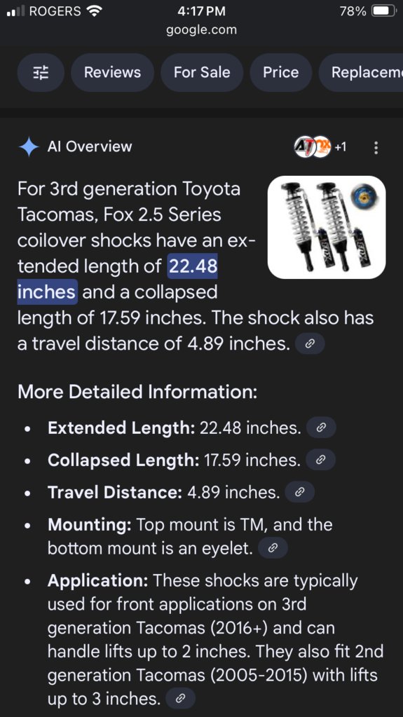

    the 4runner lifted shocks are actually longer ( EXTENDED LENGTH 22.48 COMPRESSED LENGTH 17.19)
    then the Tacoma's 2-3" lifted shocks from the same manufacture ( EXTENDED LENGTH 21.87 COMPRESSED LENGTH 16.64)

    For reference this is a fox 2.5 shock for a third gens collapsed and extended
    Should be able to adjust the bump zone to make up for the extra .25 of bunp you’ll get if needed.

    My extended shocks are 17.75/22.394" and they definitely fit because they're on now.
