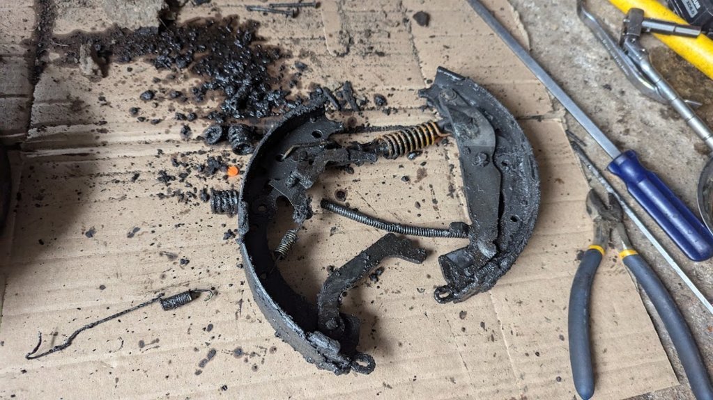

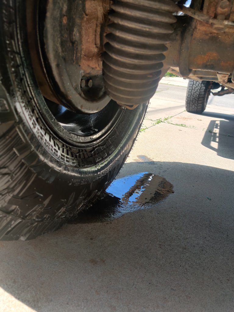

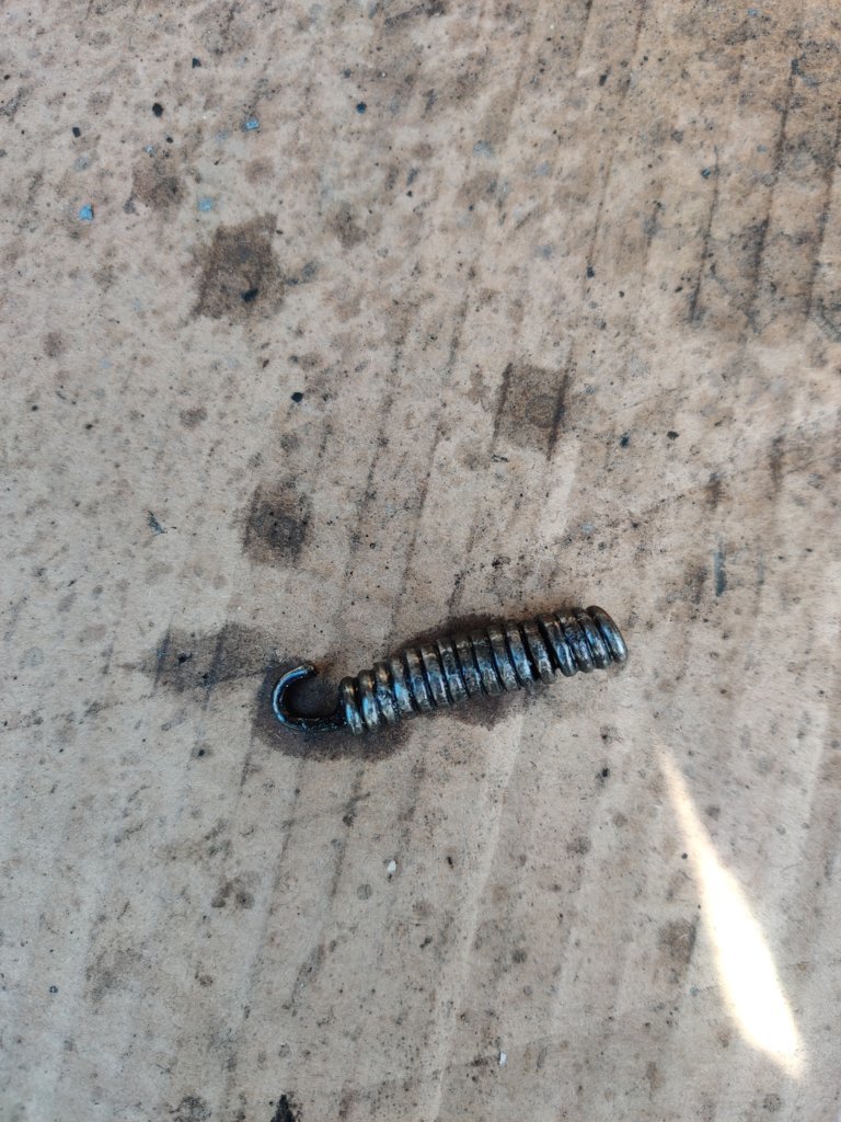

    This fell out. Looks broken. Does anyone know where it goes?

    Part of the drum brakes. Did you loose a brake cylinder or axle seal?

    Cylinder

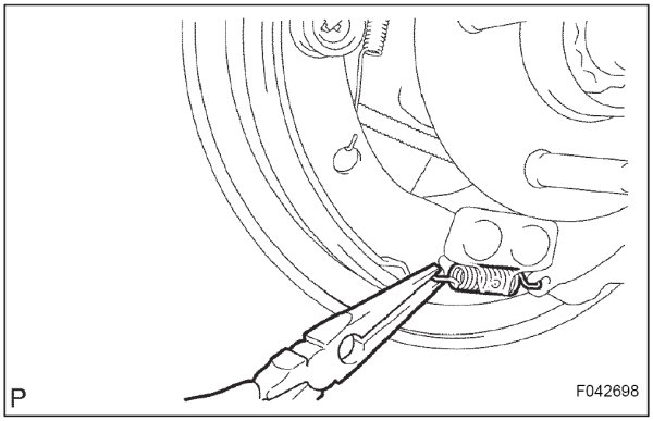

    That is the spring holding the bottom of the shoes together. If you haven't put it back together yet. Pull the axle and put a new axle seal in there just in case. Cheap insurance. But if you're anything like me just slap it all back together.:)

    Just another Friday ;) this is a one banana and two beers minute fix, guys above mentioned it :rasta:

    Gonna have to do both brakes as well. And can't get passenger drum off... Yet. Already passed the 2 beer max

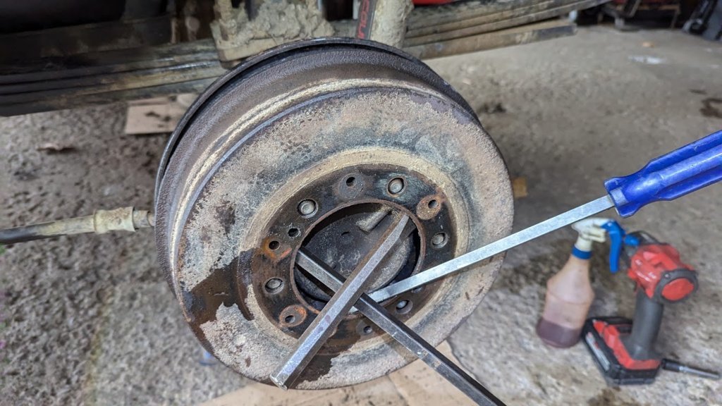

    the drum has threaded holes that you can put a m8x1.25 bolt in it to press the drum off the hub. You still might have to back off the parking brake shoes to clear the rust ridge to remove the drum.

    my last fight with drums. something broke and the shoes decided to lock them selves in

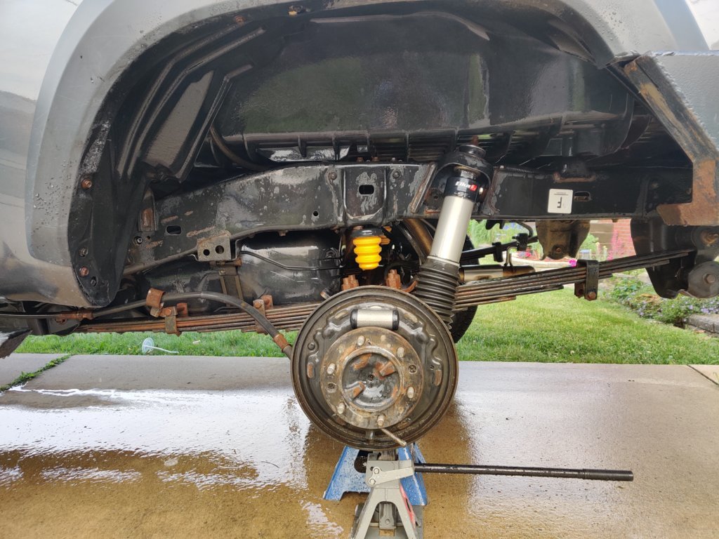

    I have now fully used and tested the Road Active suspension upgrade.
    100% can confirm it's worth. Less then $1K, 1 hour install per side to figure it out. Can take it off in less than 30mins anytime.
    This corrected the butt sagging on my rig with the trailer on and loaded, the bed box has 400lbs of kit in it for working.
    Looks perfect to me.:thumbsup:

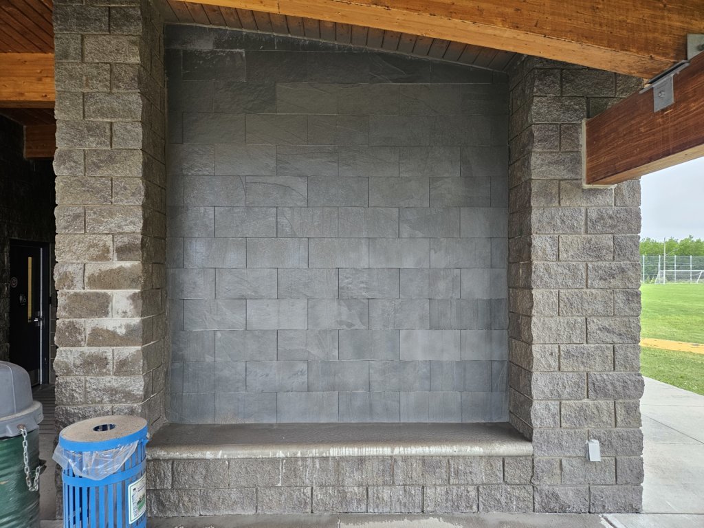

    Oh yea, this is what I have also been doing with my new business. Helping the city by removing graphiti :bananadance:
