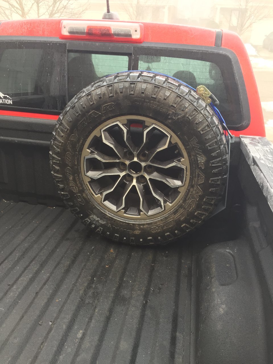

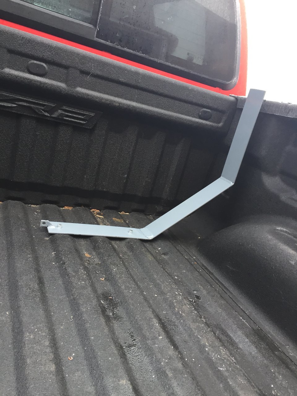

    Spare tire mount when i need the bed. Most times it wilk just float in the back with tonneau cover on.
    I still need a 285/70r17 spare, anyone!?

    Nice job! Does that have any front and back movement? I had to run two straps, one like you have it and another one across the tire to keep in from rocking. However, I didn't have it mounted as tight around like you have it.

    Yeah, back to the drawing board. I think my mounting is the leak wink, how i bolted it under the bed. Used 1/8” and i think when it moves its bending it up into the bed Vs or whatever there called. Im gonna use 3/16 piece to reinforce it under. The movement i can leave it, its not too bad and makes no noise, running a strap to the front would be perfect, ill figure a way to do that. Plus i made this for a 33 tire. So its being flexed alot to work with the smaller 31

    Yeah. Had the same issue with my skinny 33 strapped the way I had it. If you zoom you can kinda see it. Just a strap over top and across worked.

    That looks sharp!
