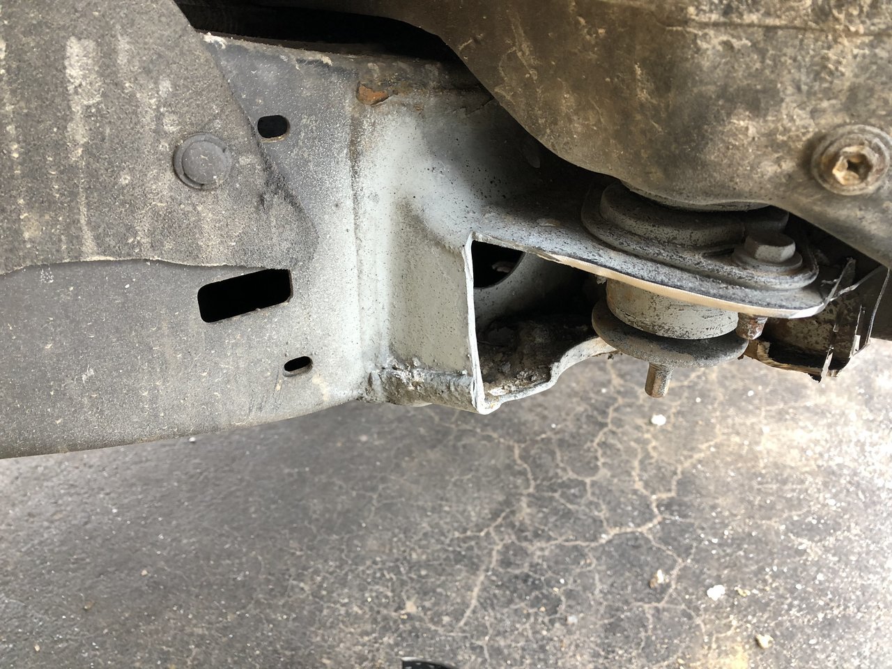

    That’s cool. I may be downloading that app again.
    Also took more off the cab mount today. This is as much as I can do before I cut into the actual mount.

    That looks so wrong for some reason

    And was it enough to back out of the driveway?

    Yes. Drove around today. Still have some more smashing to do to the firewall. I think the cap mount is good!

    Have you considered a small body lift (say 2")?

    I shouldn’t need it. I just have to continue to clearance everything. An alignment will also help if I push the wheel forward a bit.
    A body lift would help but I would only consider a 1” if I was doing a crawl box. Right now even that I would still rub. Plus a bfh is cheaper to clearance the tires compared to a body lift :D

    :eek: I hope that you're gonna replate that hole. There's not much gussetting left at all.

    I will be gussetting 100%. Just want to make sure I don’t have more to cut...

    Those compound radii should be fun.

    Yep. Can’t wait. Think I’ll be using a piece of tube to help. Pretty much going to copy the insain fab one.
