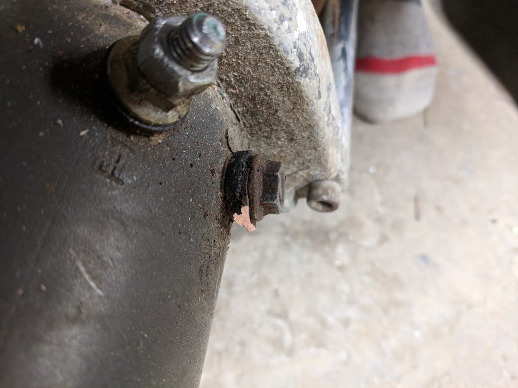

    For sure a good idea, I took out my m8000, one of the bolts was seized to the nut on the inside of the case, had to cut the cord... The other two looked new.
    u-2KRBDpCB8XsqiW19_pDQWWcJkVGNau0vNrJwcn_49792d136fec043005bde6b987b3d0e2cfa1b67f.jpg
    PO had also neglected to rotate the housing, so the bolts were at the bottom, where any water was running and settling, obviously got thru the boot and into winch case, probably also why my winch is seized.. Dielectric grease/silicone etc, highly recommended.. Also do this before the winch is mounted into the bumper, I had an impossible time getting it where I needed it..
    Also winch breather mod?
