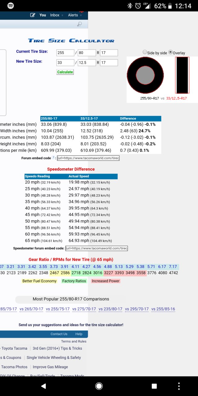

    Anyone ever run a wider tire in the rear? I've been looking and I found some Cooper st maxx in a 33 12.5 17 that would work on the trailer and the rear of the truck but not the front. Checked tire calculator and they are the same size as mine just wider.

    not a good idea because when you engage 4x4 it may mess with the t case since the wheels will have different rolling resistances due to the width.

    What are you running in the front? ST Maxx in 255/80-17? They are not exactly the same dia. but close: https://www.tirerack.com/tires/tires.jsp?tireMake=Cooper&tireModel=Discoverer+S/T+Maxx
    255/80-17 is 32.8" dia., 632 revs per mile.
    285/70-17 is 33.0" dia., 628 revs per mile.
    The difference would be akin to having 3/32" mismatched tread depths, assuming both are new tires. If your front tires have some wear and the 285s are new, the difference would be larger. You might be able to mitigate this difference by running lower tire pressure in the rear.

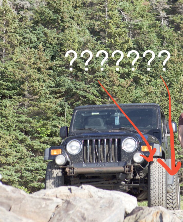

    From my experience it's the dumbest thing to do, it's a miracle that I am still alive after 5000km on those tires... :anonymous:
    But if you are up to a challenge with a natural selection, be my guest :rofl:

    It would also suck because then you need two different sized spares. Better off keeping it all the same

    This and what Peter mentioned makes sense.
