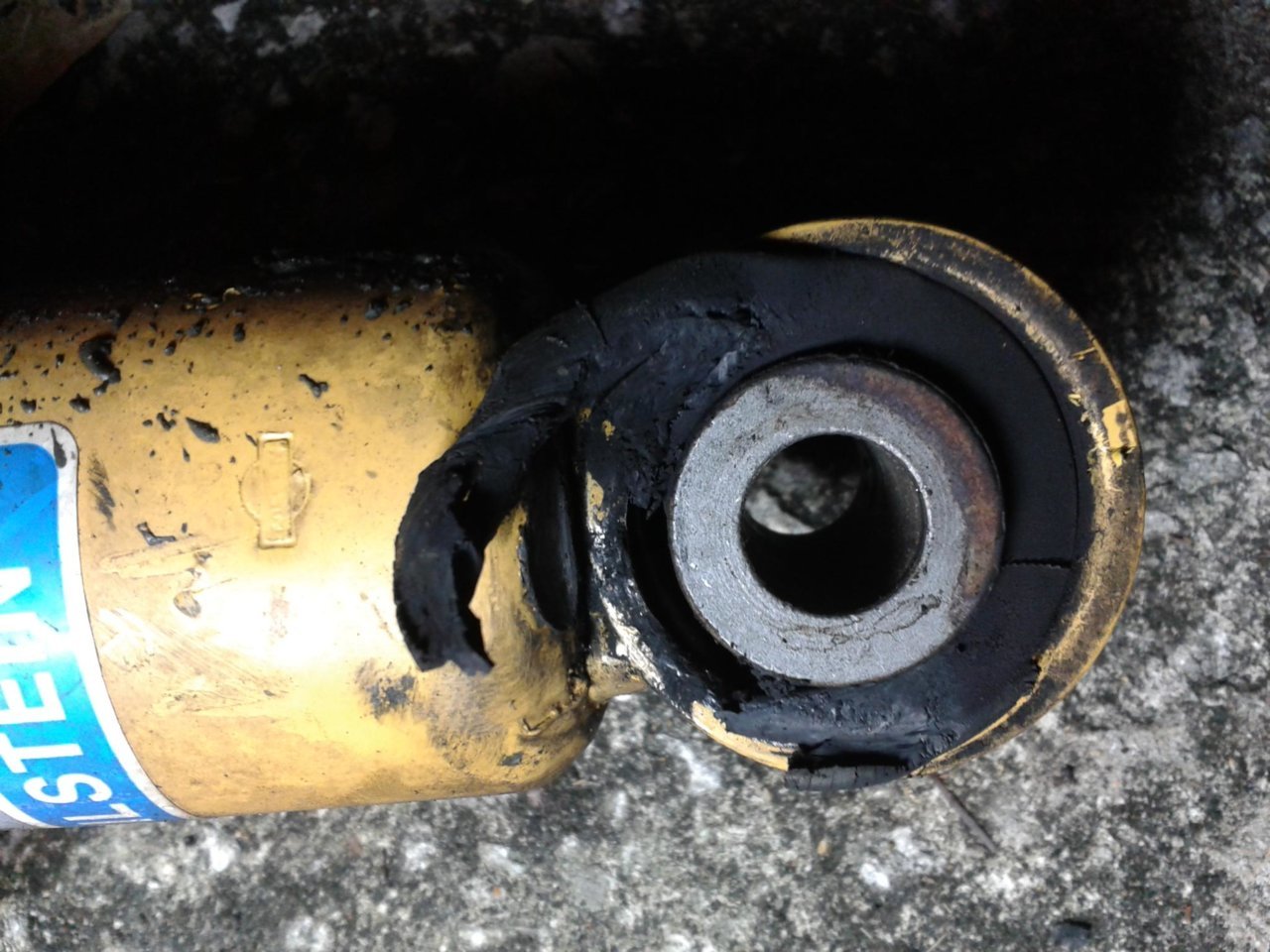

    On the TotalChaos stock length LCA's, Standard Stock Length Uniball Lower Control Arms with Dual Shock Capability they say *Not compatible with shocks with bushing lower rod ends.
    Can someone tell me what shocks have bushing lower rod ends so I know wtf that is. kthnx.
  15. Jul 9, 2018 at 10:23 AM
    tacoma16
    tacoma16 [OP] Well-Known Member
    Mar 15, 2011
    #53109
    11,164
    Peter
    Ontario
    Double cab SR5 4x4
    I’m going to assume it’s either a rubber bushing style like the old man emu use like this
    But even fox shocks have that. Maybe just not the shaft portion like the top of our rear shocks use.
