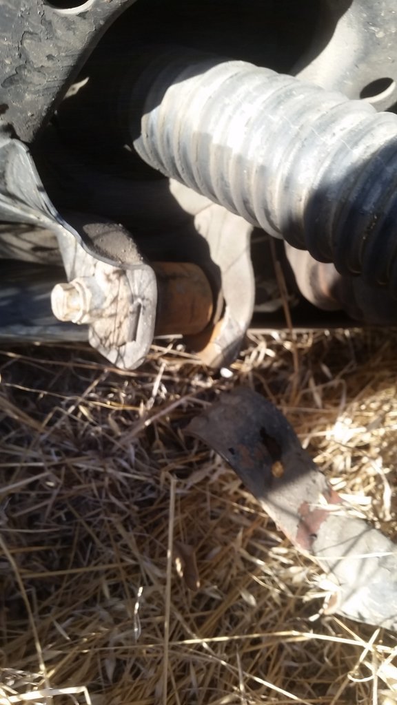

    Well I don’t agree with the strength aspect of the lca
    https://www.tacomaworld.com/threads/catastrophic-lca-failure-on-the-street-what-should-i-do.503994/
    I have read a few threads on how they have snapped similarly to the picture above. If you were to upgrade the aftermarket method is the way to go.

    Judging by the look of those trucks they were jumping and desert running them lol. In that case yes I don't think the stock are strong enough. But for our sake they are.
    Not that I disagree an upgrade is obviously stronger, I don't see them as being a major weak link in what we do.

    They are known to fail over time. Regardless with the weight that my truck it may happen. Worry about and just keep visually inspecting.

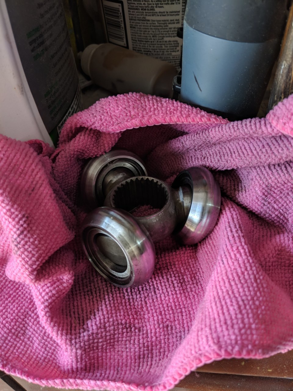

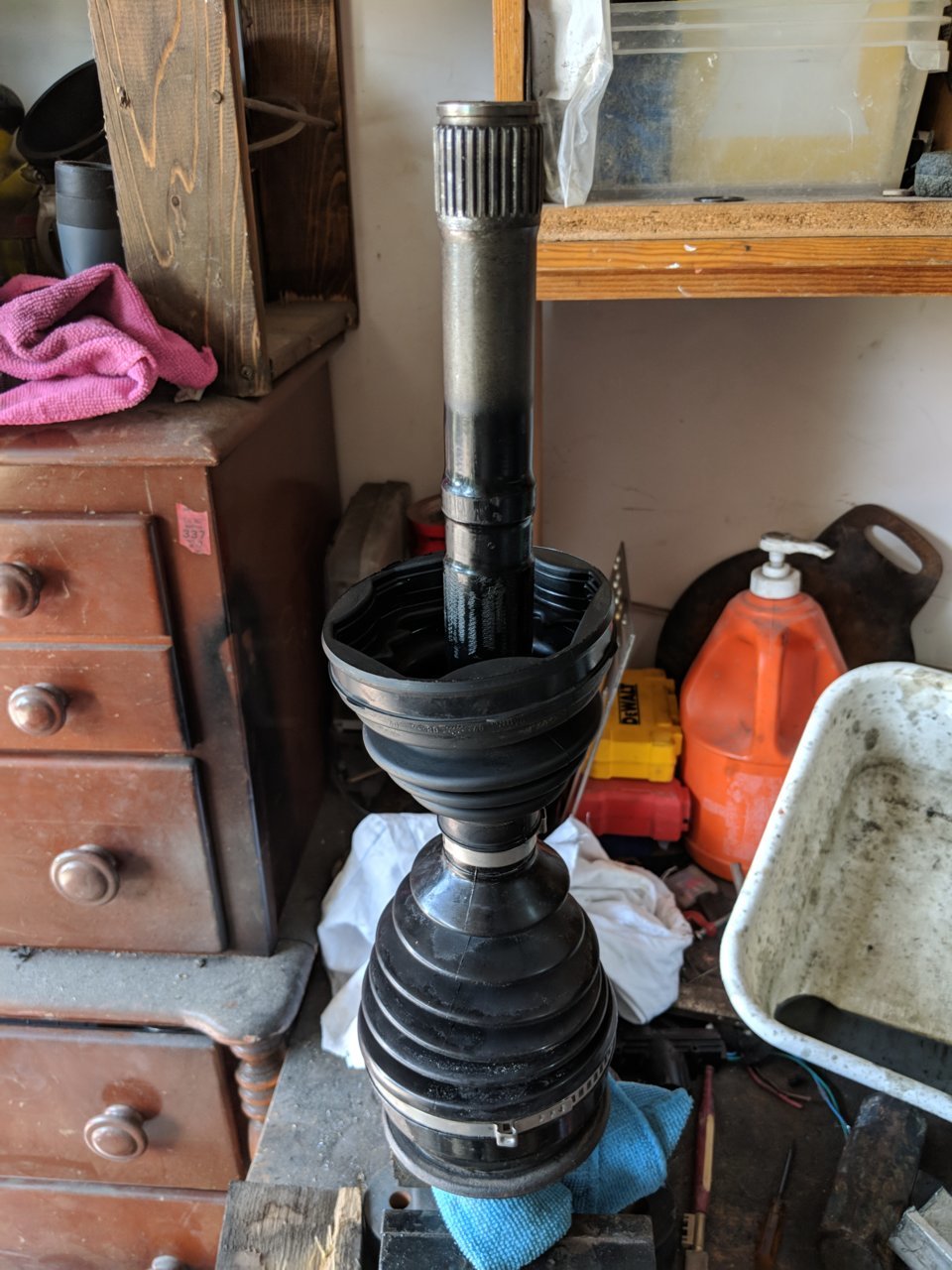

    Not fun.

    Messy not fun or painfully meticulous not fun?

    I don't mind mess. Getting that tulip off was a pain. I ended up using a 1/4" thick aluminum angle and bashing the shit out of it. I did this to replace an aftermarket that I bought and to eliminate a very slow leak from the diff drivers side. Looks like when I originally replaced the oil seal the rust ring around the exposed metal had scratched the seal sides as it went in. I sanded it smooth this time around.

    So pain in the ass not fun.
