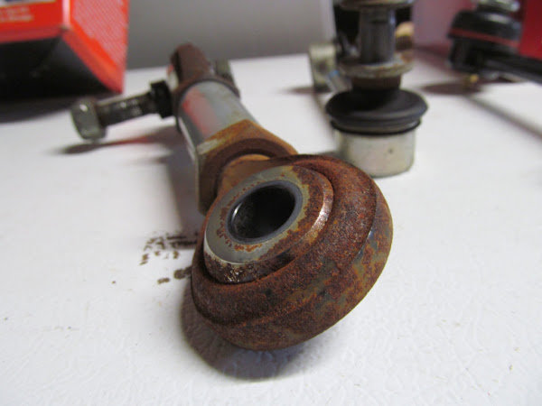

    Aaah... My AP end links were squeeking like a mofo. I tried dry lube and graphite spray... no go. The noise went away when I sprayed them with Rust Check industrial storage spray (green can).

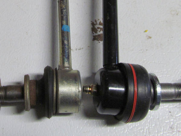

    The AP end links are not stainless or nickel plated, so they rust very easily. Mine were done after one winter, so I got Deeza HD end links for FJs (20% thicker shaft than stock). Sadly, they are discontinued.
    IMG_1956s%2Bap_links_4728237edf5d7f37209e863e860db8ab13ed1697.jpg [​IMG]
    The FK uniballs in the AP UCAs are stainless. I feel no slop in them after 6 winters. I think the noise is just the nature of the beast.
