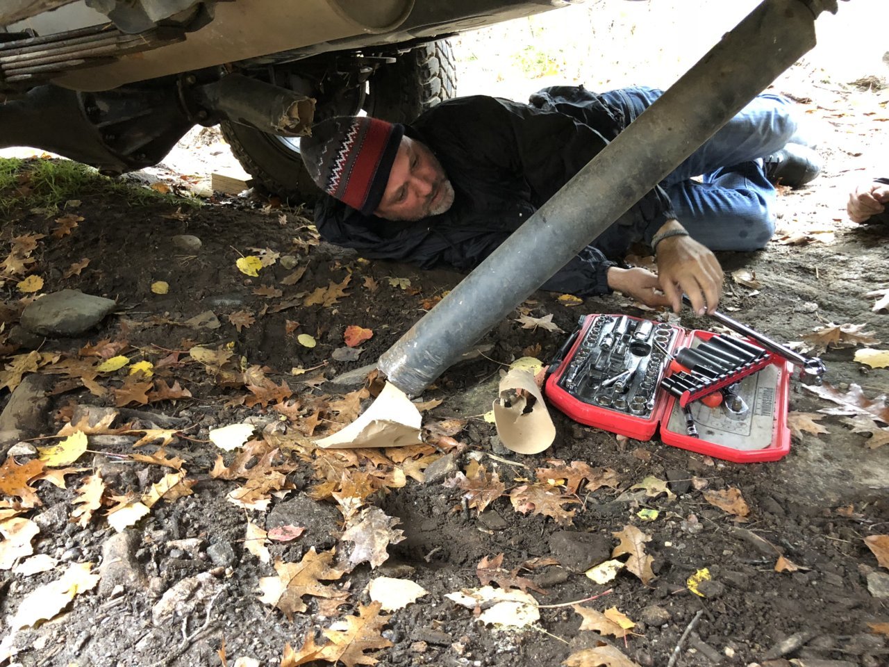

    Yeah I don't know but the mechanic was saying they can resleeve it and make it stronger if I want. I'll have to call them in the morning and ask. If that's true, I might get a thicker gauge because that will take a lot of abuse over time.

    Found a shop that rebuilds driveshafts. Complete new pipe, thicker gauge and then balanced for $350. I thought that was a wicked deal.
    For future if anyone needs it.

    Shoulda got a steel replacement still. Dclb problems, long shaft

    It is steel. Complete new thicker pipe and welded at the ends.i wanted to go even thicker but he didn't recommend it since that's normally used on 5 ton trucks and would put a lot of stress on my joints.

    I might have a balancing issue but we will deal with that if/when I get there. Our trucks have another smaller shaft that connects to the front, which wasn't broke so we left it at the time. The entire shaft is balanced as one unit. With the new shaft balanced on it's own, they might not work well together. We'll see.
