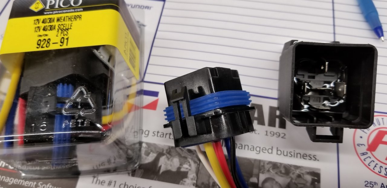

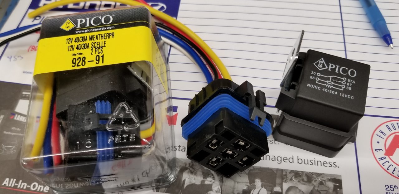

    I had a relay shootout this summer. Changing up to these weather proof ones.like $14. each

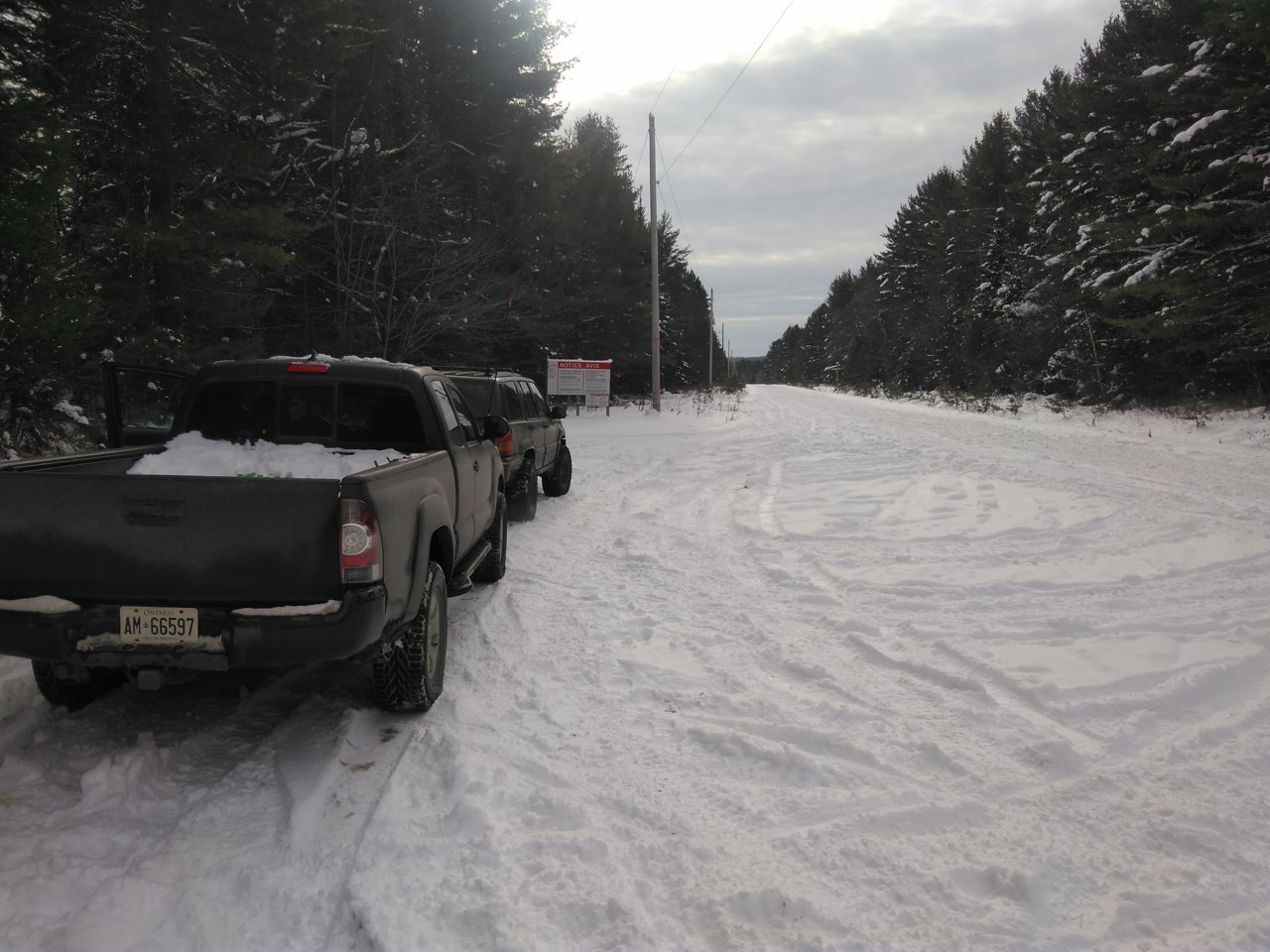

    Going snow wheeling today on VMUTS, see how stuck we can get.
    I already have the snow tires on, so it should be ok :cookiemonster:
    I will spam some pics and vids when we get back later this afternoon
    Cant friggen wait to go!:bananadance:

    So I actually cleared this up with the VMUTS board while I was on it. The VMUTS never actually closes to anything. You can take you truck, or 4wheeler on the VMUTS any time. The snowmobile trails that go through VMUTS are shared trails, not dedicated snowmobile trails.
    Sure the snowmobilers hate it when you make tracks on their groomed trails, but you can as long you stay on the marked VMUTS trails.
    We dont use the trails after they start grooming them with the trail groomer. Before they get it out and start laying tracks, its open county for us :cookiemonster:

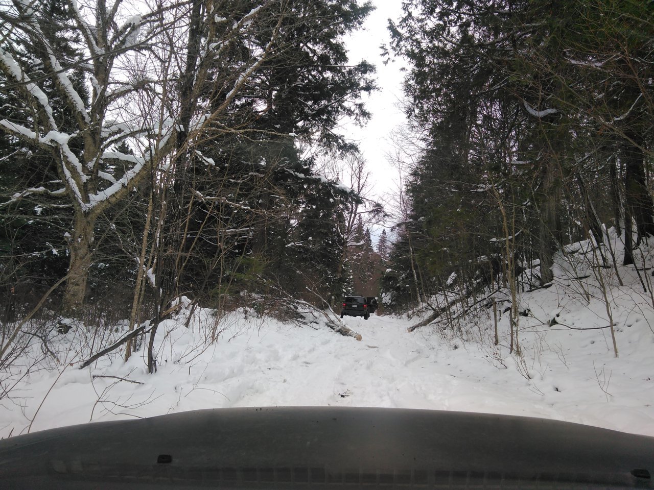

    Yeah I dont want to ruin anyone's hard work.
    Had to do a little trail clearing at one point.
    Some hunters got stuck on the trail, trying to wait to long to pack up hunt camp. They had 3 vehicles but it was not going to make a difference. My buddy got them up the hill with his winch, then it took 2 pulling to get them out to the road. The truck hooked up to the trailer had All season tires, not aired down. No locker. If we had not come along, they would have had to leave the trailer in the middle of the trail.
    :bananadance:
    Was a fun AF day, spent 5 hours in 4x4. Damn that was a good time :cookiemonster:
