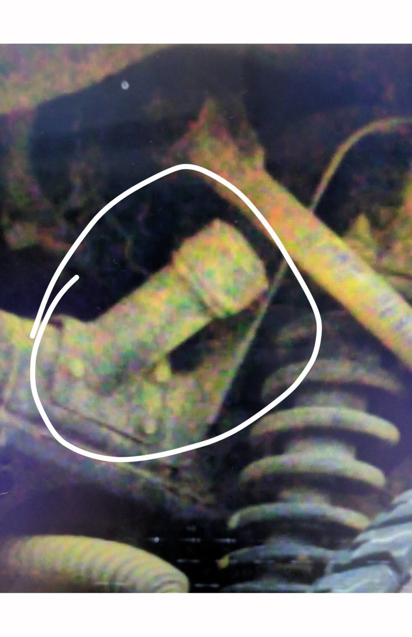

    This is the bumpstop in question was talking about. The UCA there is hitting the coil and there's about 1" of space at the bump. I was planning to cut the bump in the middle and welding a piece to extend it.

    Yeah. That seems like your only option. It would better to weld a bolt so you can make it adjustable. This way instead of cutting it each time you need to adjust you could put spacers and fine tune it.
    Also I have stock bumps so if you want to even use some spacers and the stock bumps your good to go. Thread right in.

    The adjustment sounds like a good idea. I was thinking of seeing if the rubber cap on there can be removed and then maybe tap a hole and add a bumpstop with bolt instead of welding.

    Could do that as well. Another option is weld a thicker plate, tap it and then proceed to bolt. Like I said if you need bunps I have.

    This is why limit strap is easier . The clevis is adjustable usually 1.5"

    Yeah. And can unbolt and change straps. Just hard to account for stretch.
