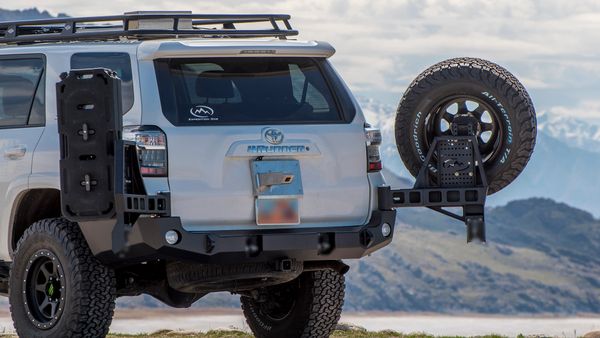

    Ouch!
    wonder if there are youtube videos of the install like you see of the CBI mounts getting installed.
    this was the most closeup picture I could find of it so far
    Their forerunner model is essentially the same system. Would that latching system help alleviate some of the stress on the post?

    It’s usually a spindle style mount. I am more of a fan of the double sheer style from 4xcomp. Uses a grade 8 bolt and some bronze bushings. It’s more repairable than the welded spindle.

    That one is a similiar spindle style as well.
    I prefer this style in terms of serviceability.
    Once you weld on the initial mount the bushings and bolt are serviceable. Where the spindle style. If it wears out you need to go to custom bearings are completely cut off the spindle and re weld it.
