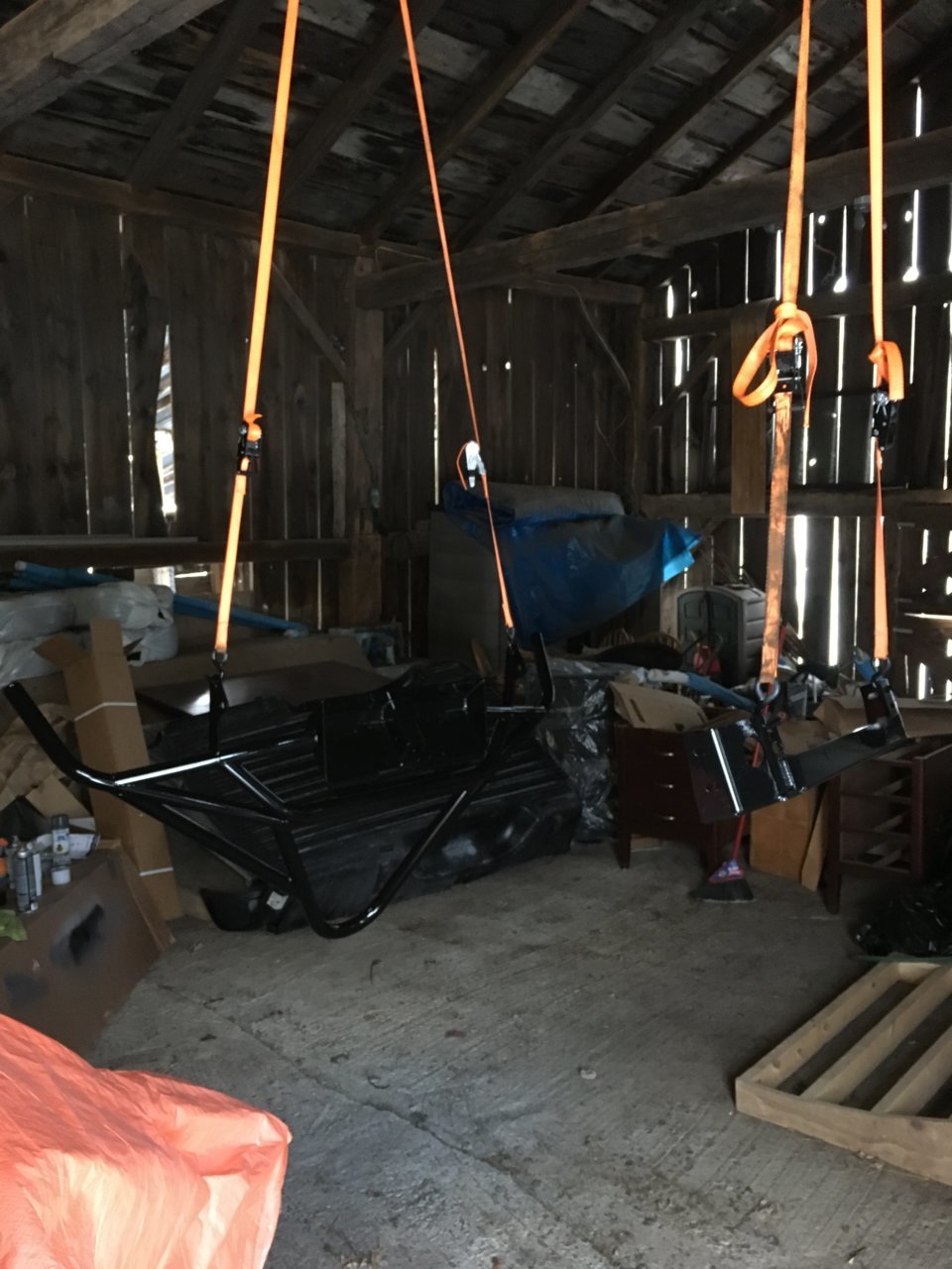

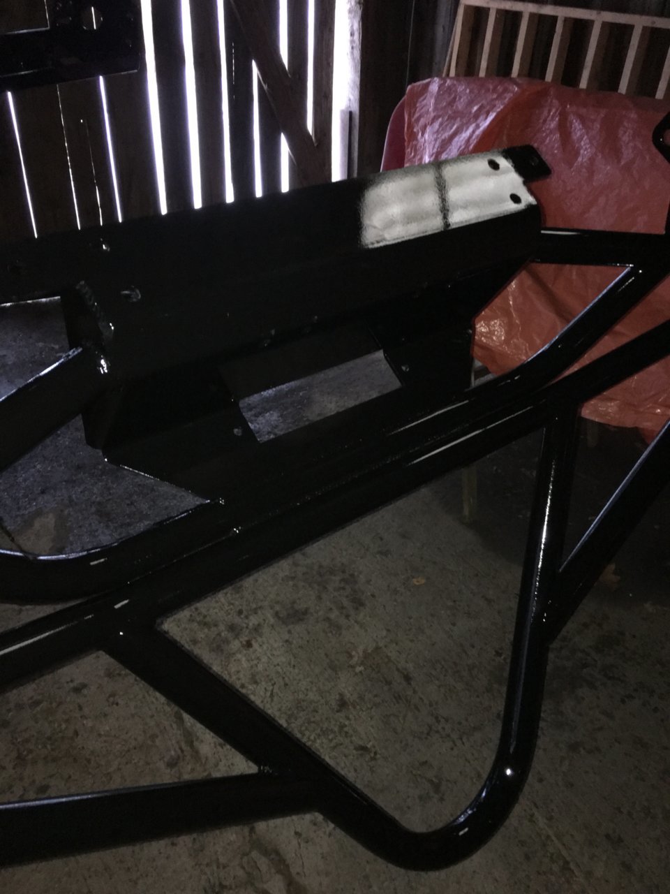

    The lady is coming over tonight so I will have to finish the final coats in the morning. Super happy with it though.

    Painting is so rewarding but waiting for it to dry (especially in the cold) blows.

    Yeah, it’s rough. I should have waited longer between coats but I was eager to get as much as I could done tonight so I can let it cure all day tomorrow and mount it Sunday.

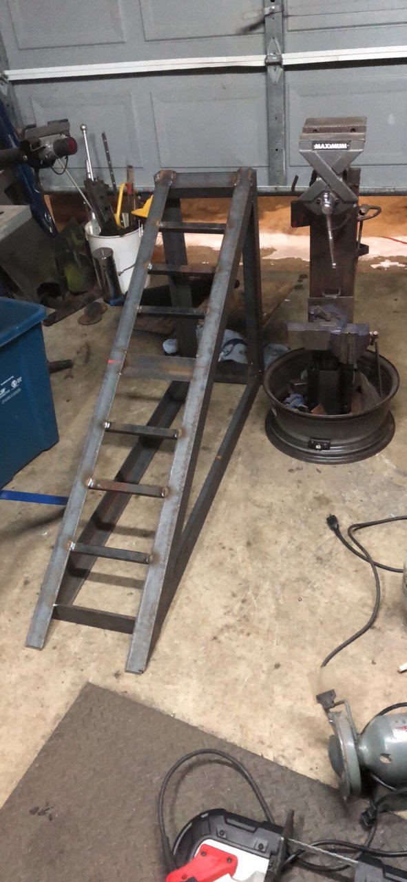

    Going to put some reinforcements on the sides to support the ramp (hypontenous portion) and figure out some brackets to prevent tipping. Then just inspect it all to make sure I didn’t miss any weeds.

    That’s gonna be sick. I bet I can get to 3rd tread until I lose traction in the rear lol
