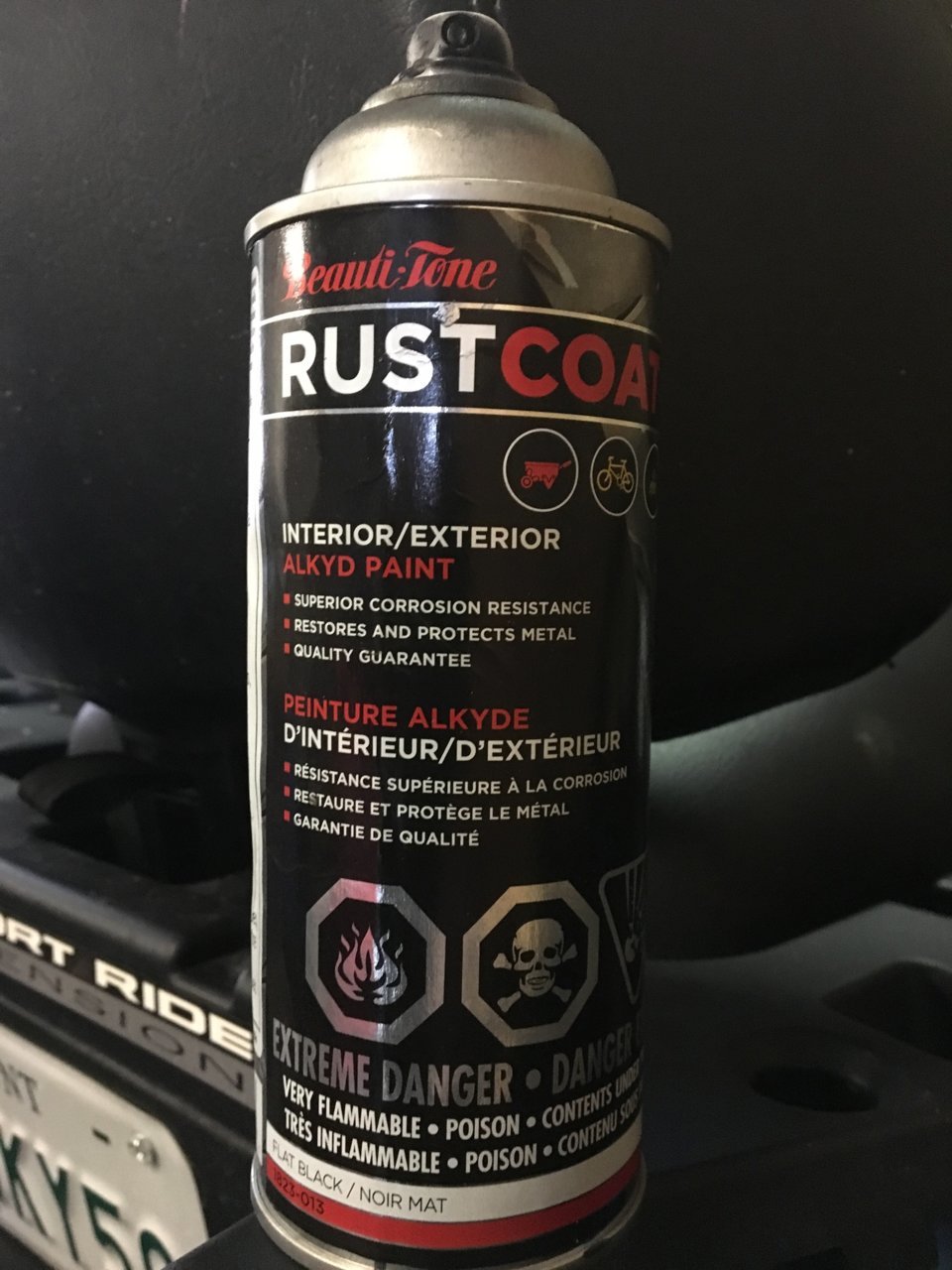

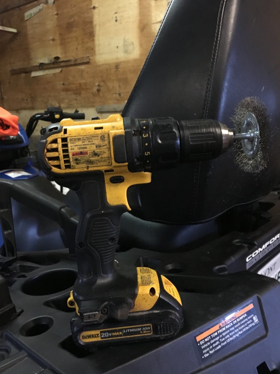

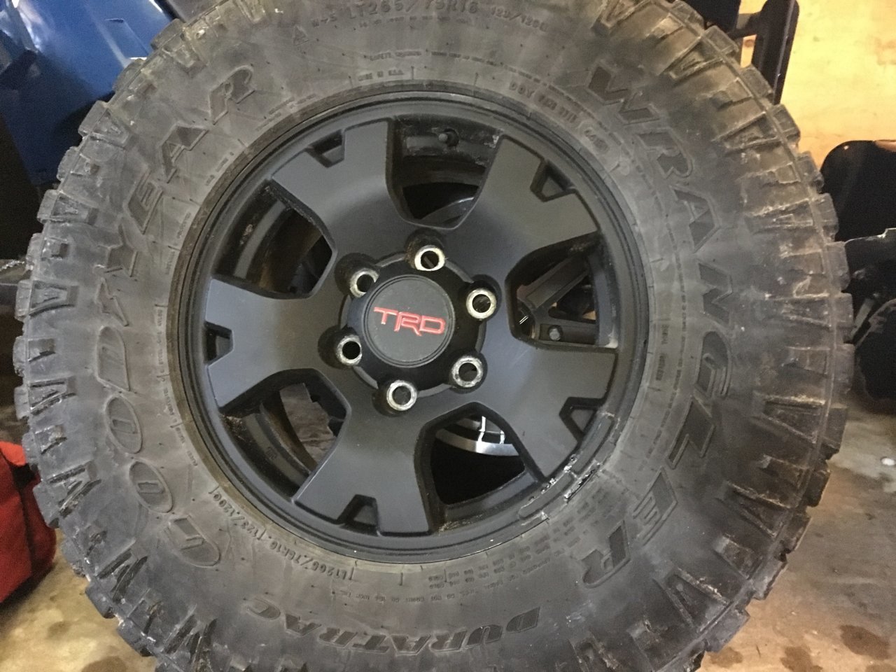

    A little work with something like this
    Plus two cans of
    Equals this :)
    You may have to repeat next year ,,,,but for 20 bucks ,,,
    Oh well.

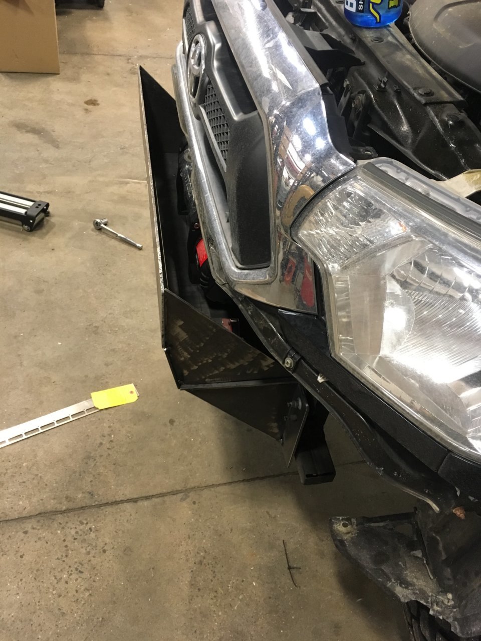

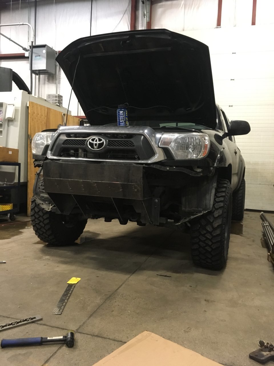

    Got around to workin on my bumper again finally...
    Ran outa steel n need tubes bent. Almost done :annoyed:
    Thyces, Sloweburn, Bocsy44 and 6 others like this.

    Nice! If I had good fab knowledge I would have made mine myself. Thought it’d be cheaper and easier on my mental health to just buy one fabbed. I’m probably going to make my own sliders though, if not this year, next.

    Thanks man!
    Bumper has been easier to build than my sliders lol
    And you can bet ill never make a full set of skid plates again that SUCKED

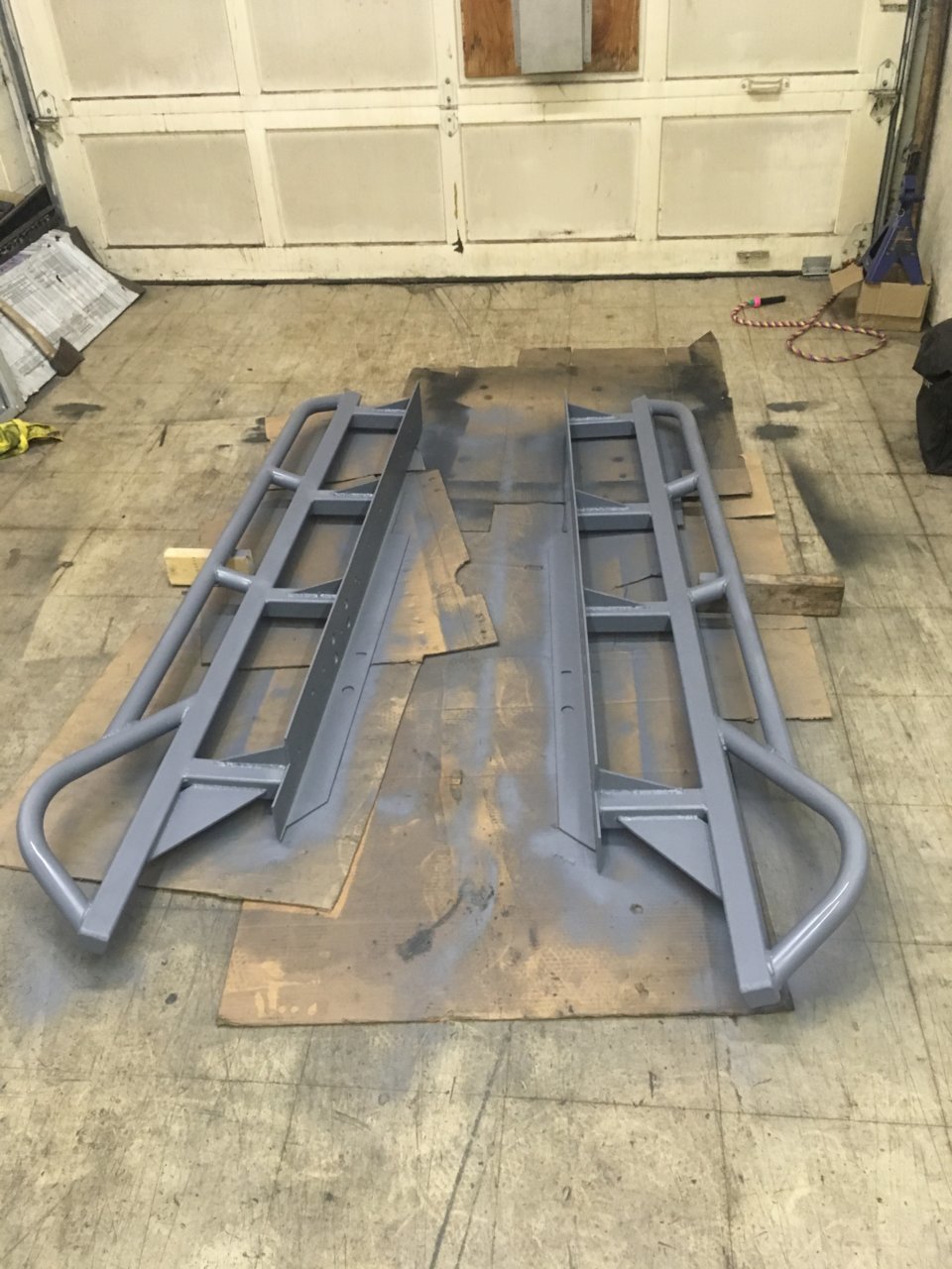

    Yeah i did 3/16 frame plate to 2”square for stand offs and the first tube angled up, had my buddy bend the 2 angles i wanted on each end of both tubes, cut em apart and just pieced it together
    I have a borrowed bender now but idk how to use it yet. Ill try it out when i build my tube rear bumper and bed racks
    Zulupapa, Thyces, Sloweburn and 5 others like this.

    Those look great, good job. I wish I had access to a bender. I think I’d be more enthusiastic about honing my welding skills if I had a jd2 laying around lol
