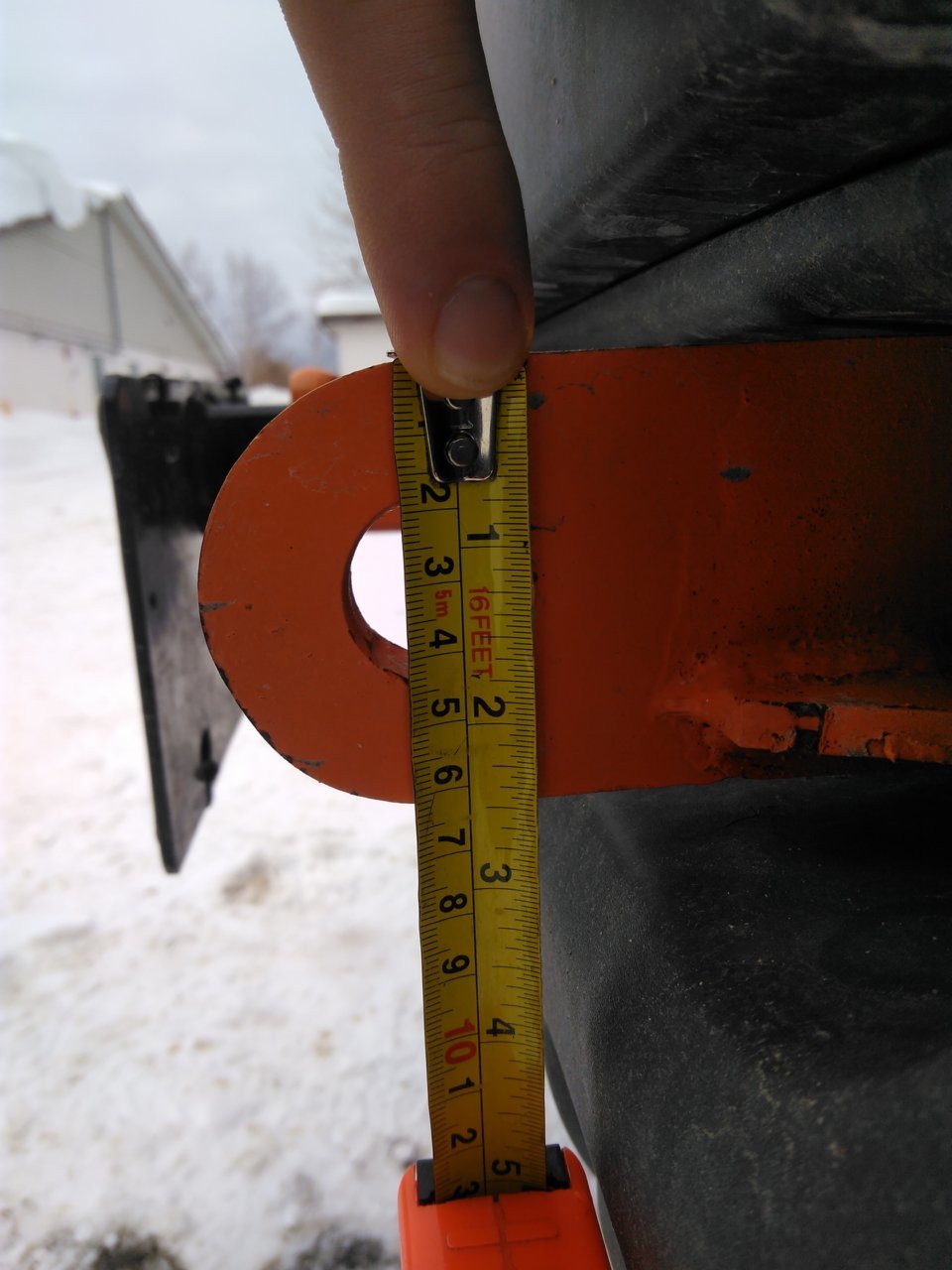

    I dont have a bumper but this is the measurement on my shackle points.

    Ill see if I can get that to you tonight. Ill do it in relation to something that doesn't involve height from the ground since suspension and tires affect that.
    this may help in the mean time
    essentially it mounts on the side of the winch cradle

    Guess I was confused about what the blue arrows indicated :cookiemonster:

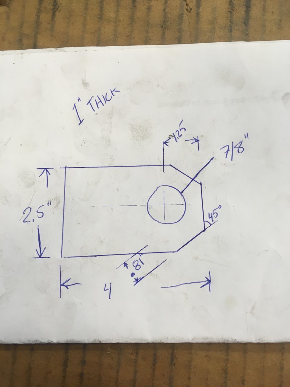

    Good enough, time to go drink beer :cheers:

    Great job! I need to make some. What are your dimensions?

    Drawing is not to scale haha

    Thanks! Appreciate it
