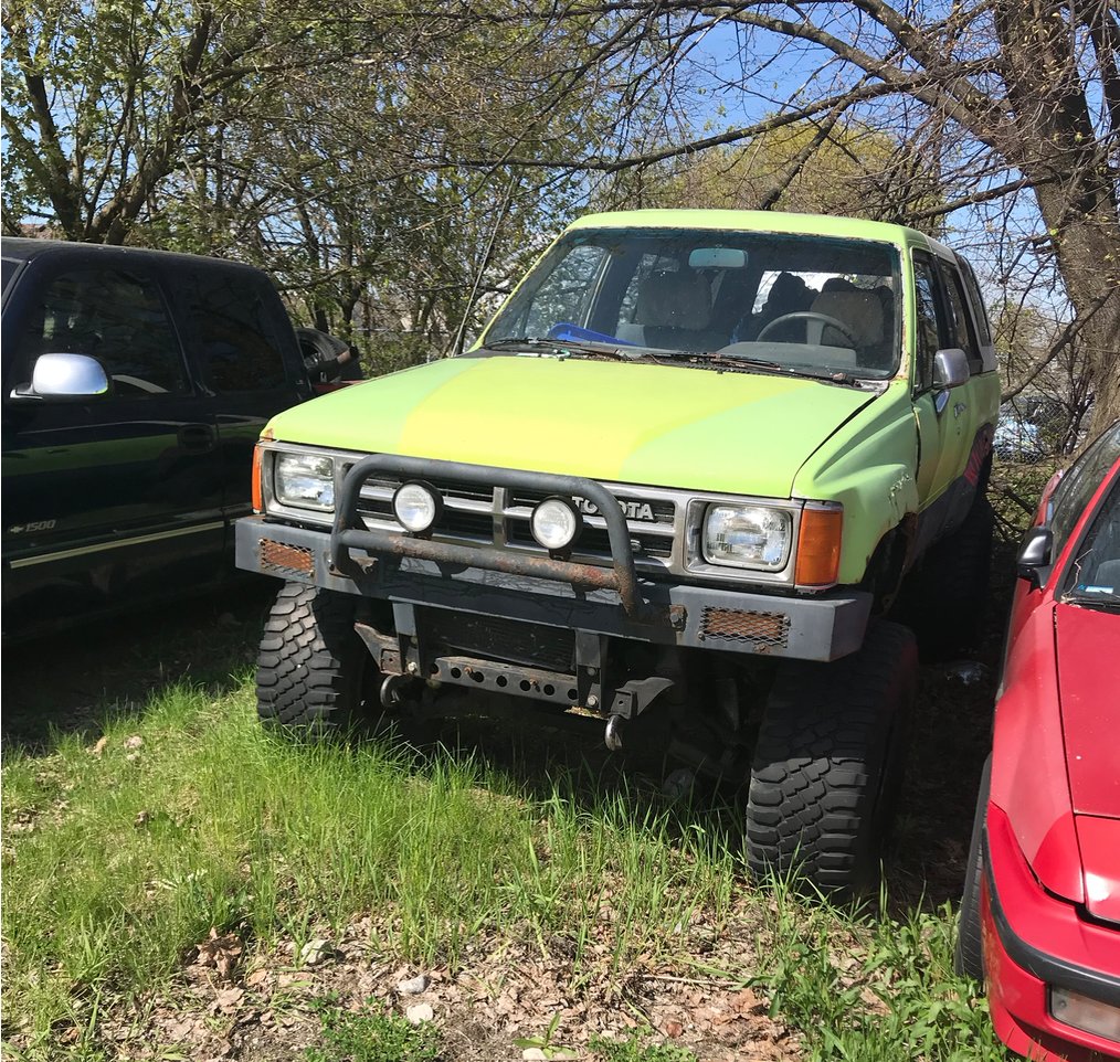

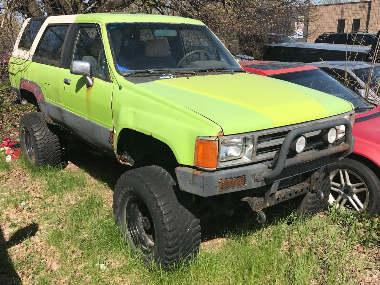

    I've seen this truck for years sitting at the back of a used car dealer. It's full of junk. Seems like an undignified end for it.

    Ontario Project truck?

    1st gen 4Runner right there my friend

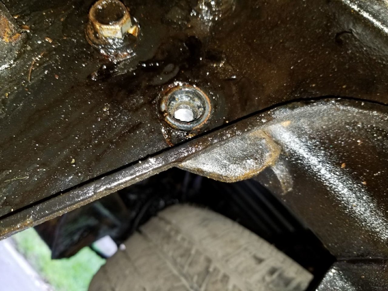

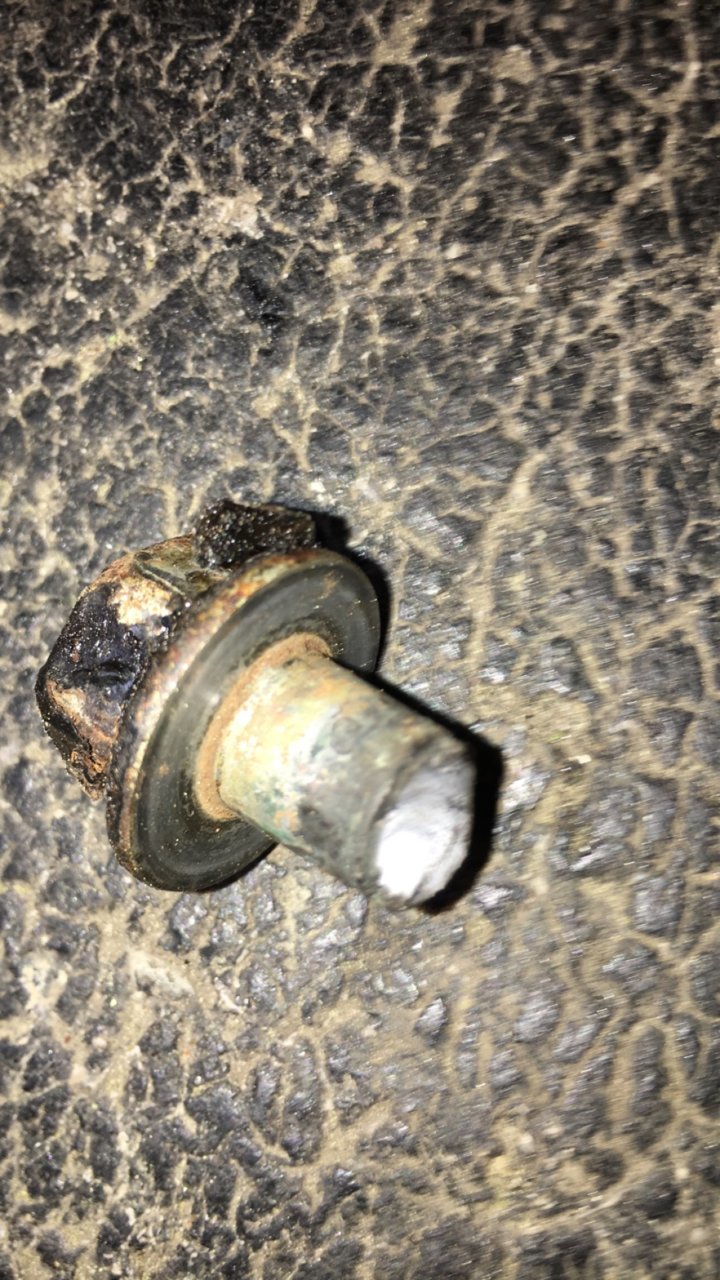

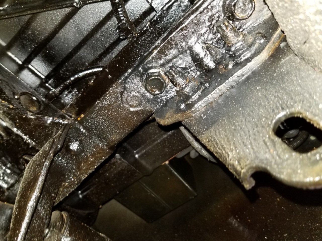

    71927453-39C9-407A-95F1-7C69DC502D87.jpg 1B0F8A78-C634-485D-B0F1-A5B67CFFCBE8.jpg Sheared this bolt while trying to take my reciever off, I’ve never tapped a bolt before. Any suggestions ?

    Cutting or threading oil when both drilling and tapping.
    The brand Walter makes a gel thing that works incredible for tapping. Forget what it's called but it's a blue gel. Looks like that stuff you put on a sun burn.
    Otherwise rigid threading oil works good too.

    I assume you don't have torches.
    Center-punch the center of the old bolt. Give it a good couple of whacks.
    Blast it with penetrating oil.
    Use a LH drill bit (if it is a blind hole, RH bit if not a blind hole) (if you buy the cheap screw x-tractor set from Canadian Tire it comes with LH bits or good tool supply places have them).
    Use a small bit to get the center punch hole deeper (~1/4") use lots of cutting oil and keep it going straight down the center of the bolt.
    Use a bit about 1/2 to 2/3 size of the bolt and drill the rest of the way through the bolt. IF you a REAL lucky the bolt will move or back out as you are drilling.
    If it has not come out yet will then just use the drill bit sized for your tap and it will be easy to drill trough with most of the old bolt gone now, lots of cutting oil.
    Tap away...
    Keep your eyes on Kijiji for a small torch set.

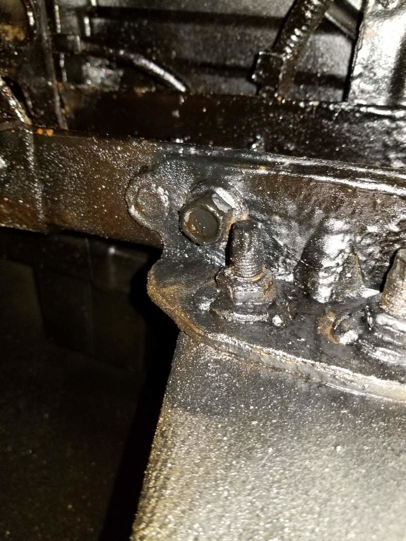

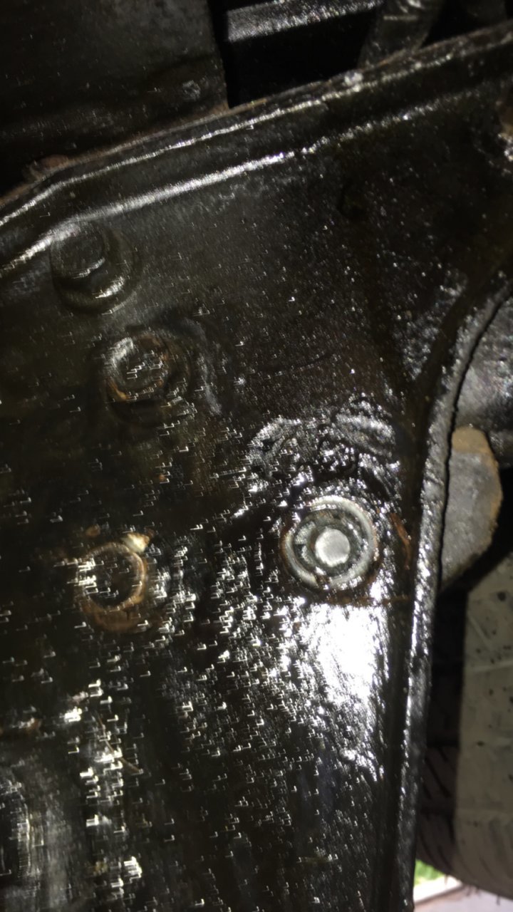

    928B0AB0-71C0-4A34-8F50-EE1414FBEE26.jpg C3B6FB25-A560-48C8-8F9C-0445106F7F00.jpg DCFD81B2-5F00-424F-8BBA-A7EEC25E5355.jpg
    Thank you very much, I’m going to have to go and buy the drill bit and removal bits. What’s the difference between a blind hole and non blind hole? If I use penetrating oil and a torch will the oil catch fire?
    I’m curious if the new frame comes with the bracket that my bolt sheared into

    Blind hole is one that has a bottom. Like in a cylinder head.
    If you can see the other end of the bolt and it's all rusty you don't want to use LH bits.
    Use RH (standard) as you want the bolt to go forward and get pushed through.
    Wipe off the excess oil before you go firing up a torch. Or don't, and use more oil and collect insurance then the problem kinda fixes itself...
    Is that asphalt undercoating on your truck?
    Uh Oh, if you are using a torch heat up and scrape that shit away from where you are working, not only does it burn very well but it drips while it is burning...
    Don't want a flaming tar drip landing on an eyebrow or a nipple.
    Keep wet rags handy.
    Then after you get that bolt out consider oil spraying your truck, rubbery/asphalt coatings work for a couple years then accelerate corrosion by holding dirty water in next to the frame.

    Ahh more pics, yeah you may be able to get some vice grips on the end of that bolt and reef 'er out from the back.
    Penetration oil and/or a torch will improve the odds.
    Otherwise... drill time.

    This is the undercoating from Toyota
