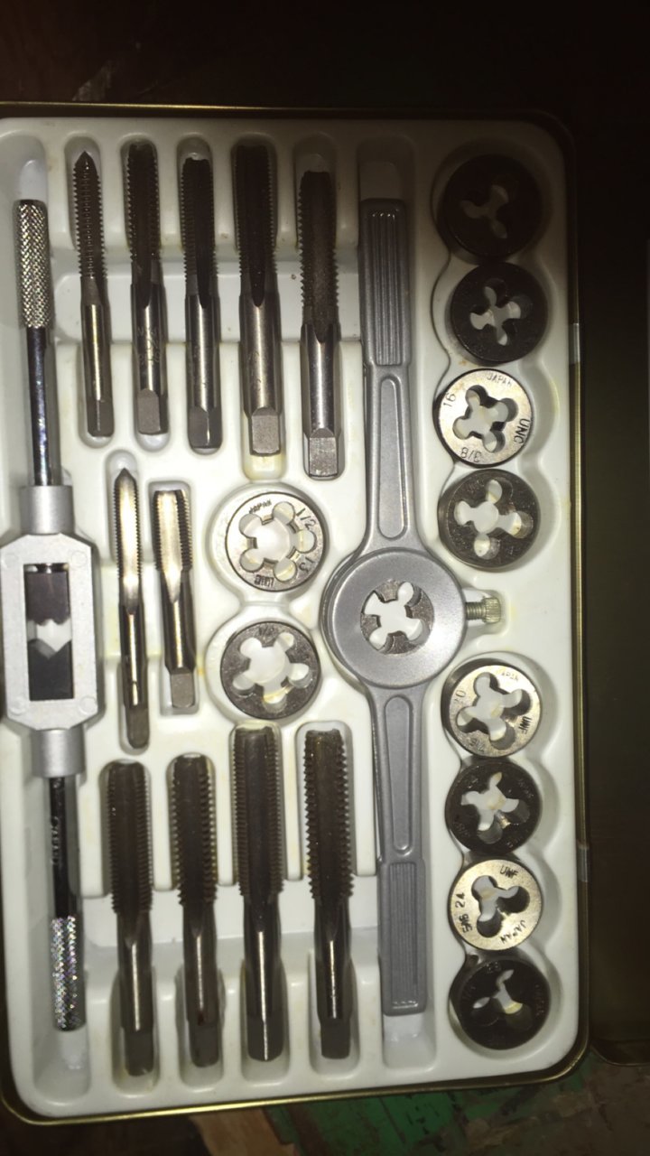

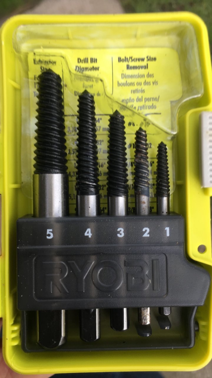

    Found these in my shed, the top set was my grandfathers. Do you think I could try and push it all the way through too

    Top set is probably not metric so no use, unless you re-tapped and used an imperial bolt.
    Bottom screw extractor set would only be good if it was a blind hole. You don't want to back that bolt out now as it's less work to take it out the other way, if you can.

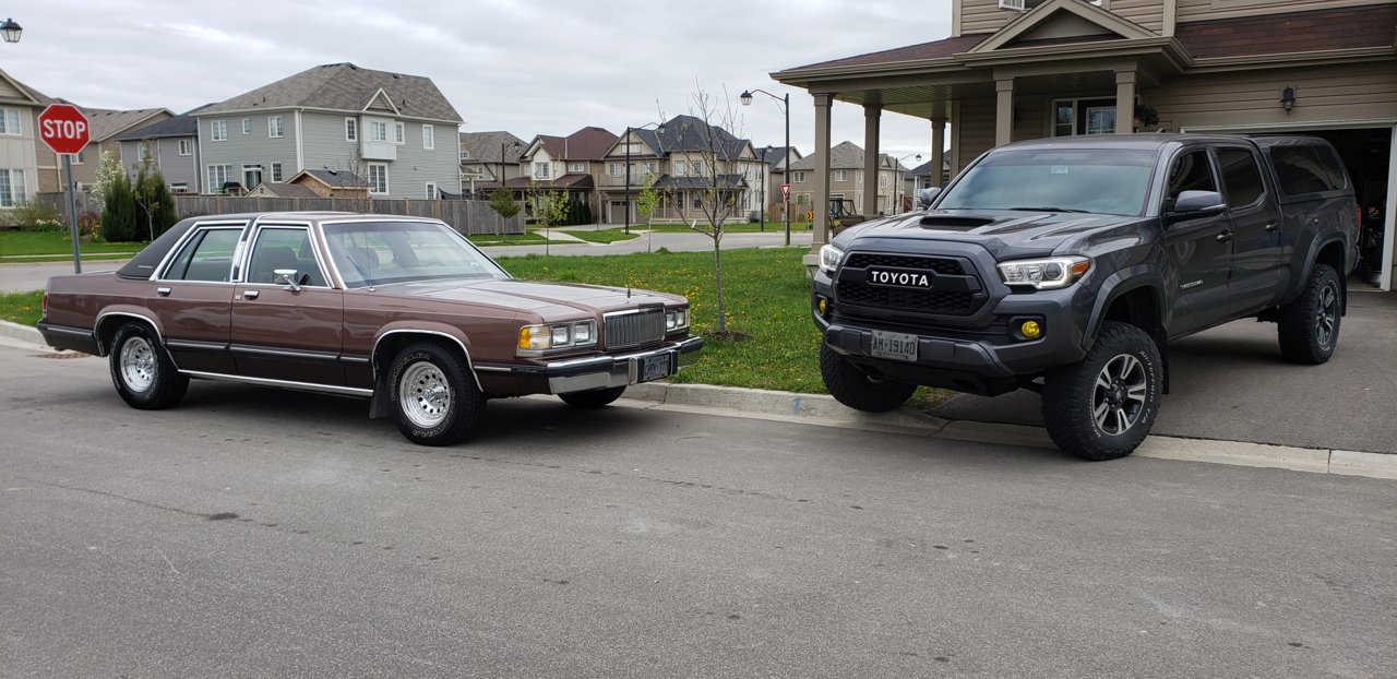

    Nice!
    My first car was a 1986 Dodge 600.

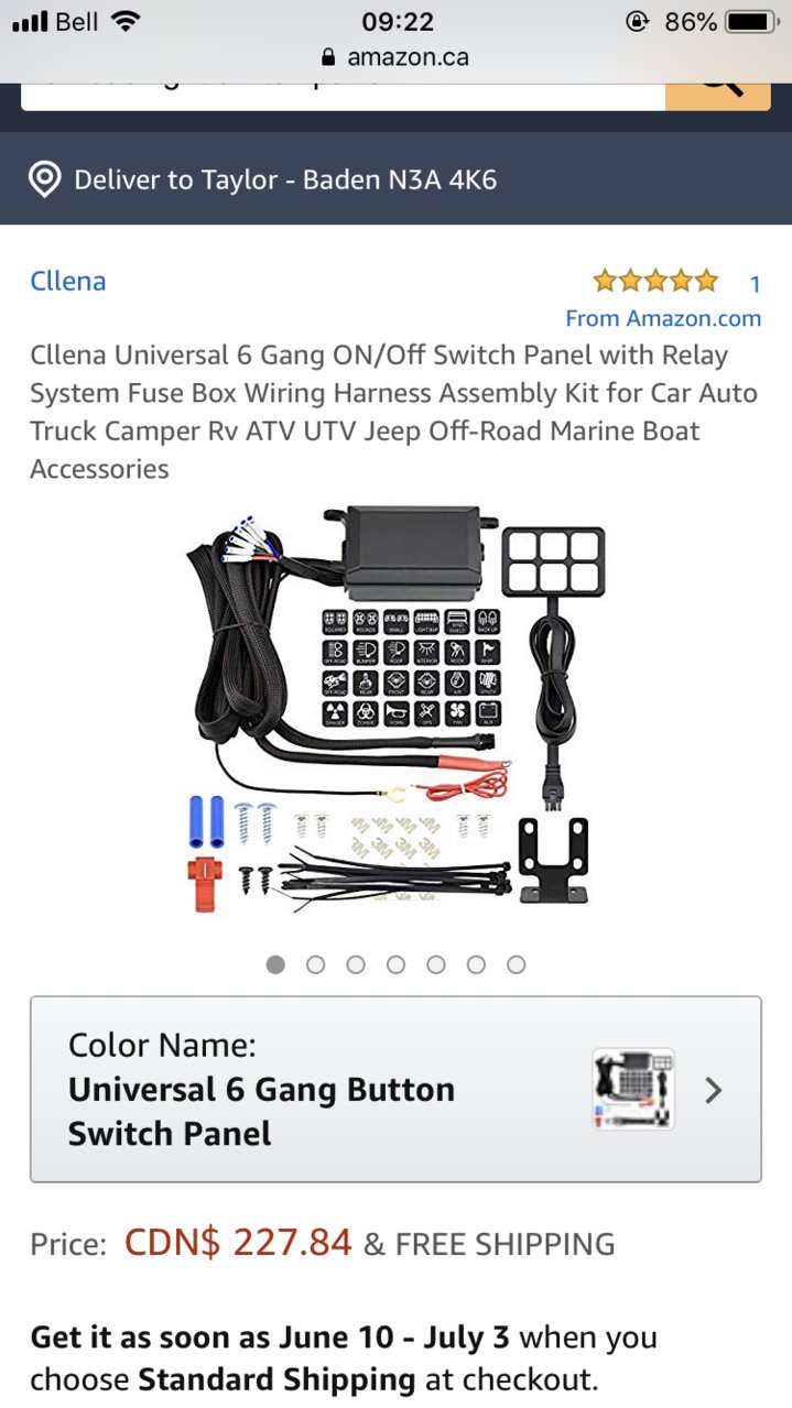

    Isn't Spod around 5 or $600?

    Just get a spod

    I just don't have that many acessories that I need one. I have 2 more blanks I can use up and keep the stock look for now. Thought the Princess Auto system was a cool alternative without running wires into the cab.
