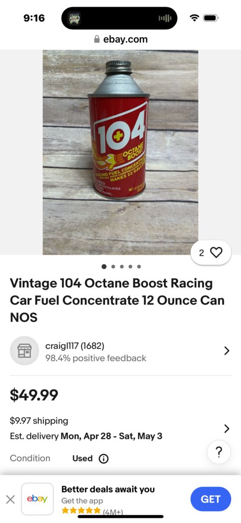

    Anyone old enough to remember this stuff for the weekends with your parents car?
    All Visible Hues 14 likes this.
