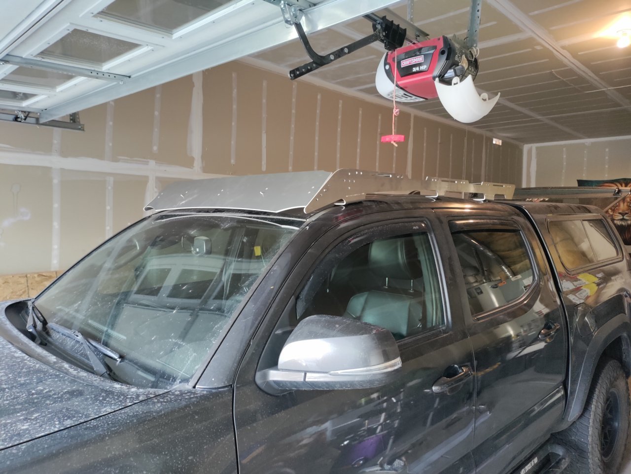

    Here's what mine looks like irl. I definitely mess up on the back mounting tabs though. They are about an inch too far forward. Luckily a coworker can help me cut and reweld them. Also not shown is the matching rack for the camper shell which I also F'ed up. Didn't account for the back of the camper shell being slanted forward and the side panels are way too long. I will also have to cut those.
