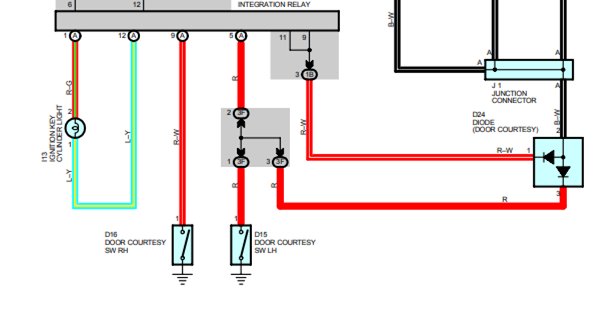

    As you can see below, those switches on your A-Pillar (door jam) that activate the dome light depend on the screw holding them on to get a ground. I'd confirm: tightness; lack of rust; and continuity through the switch.
    The following is assuming no weld nut, but a self tapping screw holds the switch in place. If it has a weld nut inside the pillar, disregard.
    I'd probably take the screw out/remove the switch, tap the hole with the head of a ball pen hammer to flatten the sheetmetal a bit where the hole is at, and then re-install the screw. Being a self taping screw, the hole gets loose the screw will no provide a ground circuit.

    Each door has a switch for the light. I was referring to checking the switch on the drivers side. It's the black "rubber button" looking thing on the vertical surface where the front of the door contacts when closed.

    In wiggling the switches inside the door jamb, I can sometimes get the dome lights to come on. So maybe pulling that black rubber boot will allow me to clean up that switch a bit? I feel like the ground wire is worth checking out as it has been mentioned that the self-tapping screw can loosen a bit over time. Where can this ground wire be located in relation to the door jamb switch?

    It is almost certainly the switch or the ground. You just need to get in there and see what's going on. The ground wire in this case is the bolt/screw holding the switch in place. Do you have a multimeter to check the switch for continuity?

    I'm on the same page and tracking now. I guess I was thinking about testing the switch installed on the truck and trying to figure out if that were possible. I do have a mode on my multimeter that beeps if there is continuity. So I'm thinking tonight I'll pull both switches, and then check the continuity between the terminals when the button is not depressed (door open, circuit should be closed) versus with the button pressed (door closed, circuit should be open).

    yes..the screw grounds it...so the switch should have continuity open..and no continuity while depressed..you could pop it out and connected the wire to ground to
