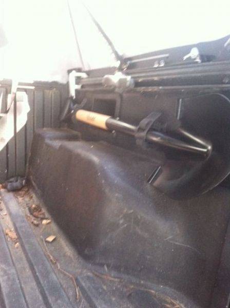

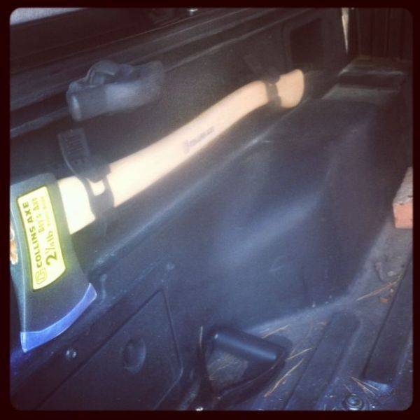

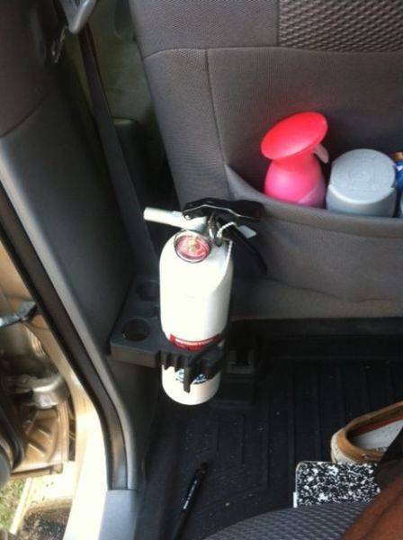

    Small update:
    -Added an shovel
    -Added an axe
    -Added a fire extinguisher inside the cab, going to get a bigger one for in the bed.
    Gotta mount the hi-lift sometime this weekend.. THe CB install is getting backed up to another day.

    looking really good! i need to get a fire extinguisher for my truck.

    After talking to steve @ Southeast Overland, i figure i may as well have it just in case something were to ever happen. I like being prepared for stuff.
    Once i figure out a good place for the big fire extinguisher in the bed i'll get that one too.

    You like the quickfists?

    Yeah, they are pretty quality stuff, they hold my axe and shovel with ease(they are rated at 20lbs apiece. Super easy to install... Just gotta get the ballz to drill into the bed haha.
    One #10 screw and the washer they provide and you're set.
    For the fire extinguisher i had to modify it because my mounting location was thin compared to the bed and one screw wasnt strong enough, added 2 #10 screws to the mount and i was butter.
    I'd reccomend them to anyone honestly who wanted to mount something small (shovel,axe ect) in the bed.
    Im gonna get another one for my bigger fire extinguisher so that's saying something.

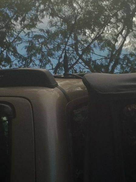

    New question: Is there a way to run the wire from the antenna to the cab cleanly?

    I ran mine underneath the truck into one of the holes in the floor, where the tail light harness runs from.

    SO i should start looking for a hole in the cab to run the wire through? it's near the bottom right?

    The one I used was underneath the drivers seat. Ran the wire through and sealed it up.

    agree you will see the rubber seal pieces you can punch hole and feed wire through then just seal the hole...or make smaller hole than gauged wire and its tight around wire
