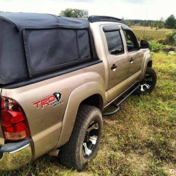

    Nice sliders on your Taco, square tube is the way to go.

    The sliders came out real good i think. It was worth the wait!

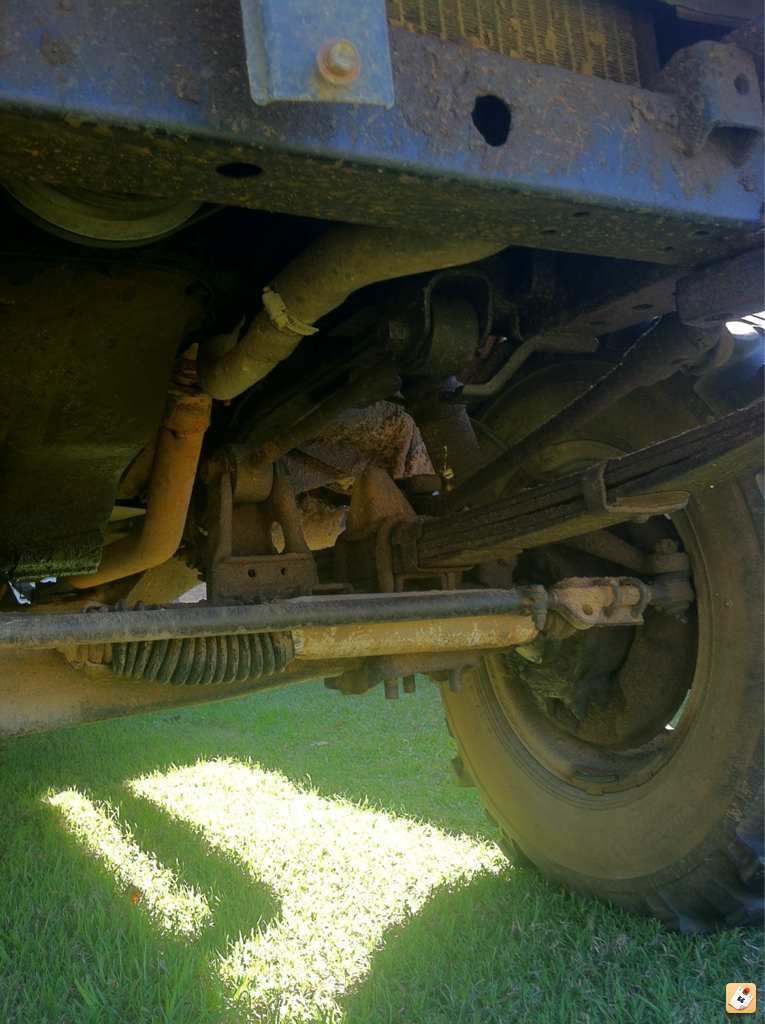

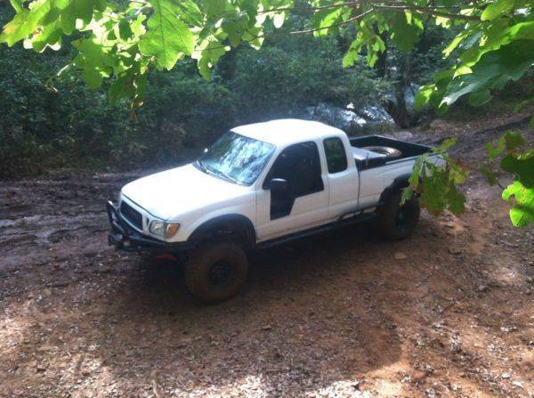

    Yeah... The two money pics in a poser shot
    The front end
    Can someone explain to me what I'm looking at? It has like leaf springs and like two sets of shocks I'm not familiar with this suspension setup at all...
  7. Oct 15, 2013 at 8:29 AM
    #387
    Sandman614
    Oct 26, 2010
    #45273
    36,013
    Tim
    Garner, NC/Boone, NC
    '06 SR5 Off Road
    Are you talking about the Steering Dampener (white shock, going left to right) or the "track bars" going front to back?

    I didn't know what it was called. :0 I'm prob gonna upgrade the suspension, just wondering what that stuff was. Thanks.

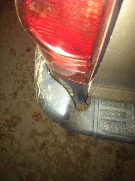

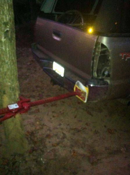

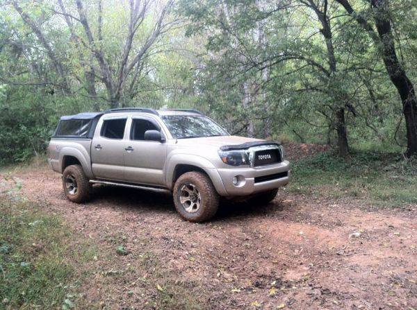

    Me,Chad and blake went down to Carver mills rd yesterday to do some wheeling. My first real experience with rocks, mud, hills and all sorts of stuff i thought this thing couldn't do. I was shocked.
    pics.
    And this is where it gets funny.
    We were riding in the creek ( i havent done the diff breather mod-gotta do that lol) And i was attempting to climb various hills. After coming straight out the water my tires were slick and the sand was super soft so i couldnt get any traction, After backing down a hill i heard blake honk his horn at me. I had backed straight into a damn tree. Lol
    I pulled off of it,painfully i admit and we kept driving. I found a sweet hill that i eventually climbed and we check out the damage, It was straight fucked up lol. But luckily i had my hi-lift and we came up with a plan

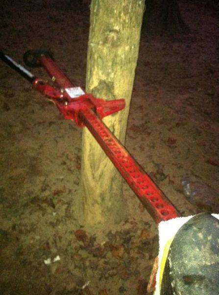

    We removed my tailight and placed my hi-lift against a tree, using my towels so it didnt scratch up the bumper.
    Pics of said setup
    We started jacking the lift and sure enough it was pushing the bumper back into place! :D
    this is the side that was undamaged.
    And the fixed side: :D
    Freakin looks good to me, you cant tell nothing. I got lucky there but now it means i've gotta get a move on the rear bumper haha.
