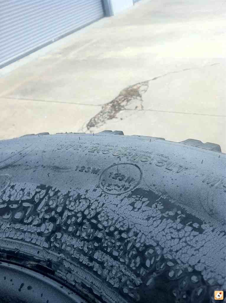

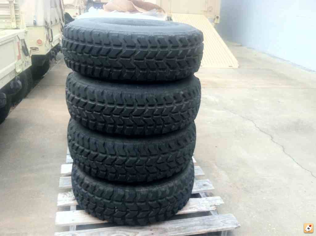

    In other news I found a set of tires for my pickup... 37s... Military issue baby
    37x12.5x16.5
    Ill have to wait a couple weeks for them to come in but I'll have a free set awaiting me for the truck...
    Bead locks and all.. I love the army.

    Those look rough!

    X2 and heavy

    might wanna regear
    go ahead and get some 2 1/2 ton rockwells while youre at it

    Man, my brother in law has an F350 diesel with those same tires. I helped him bolt them on. Heavy as F****. I'd supercharge and regear for those beasts.

    ya those look heavy! going to be even heavier with bead locks. def re gear that pick up if they are going on it.

    37s are a bit much for toy axles, youre gonna be breaking birfields about every time you take it off road, also that little 22r is going to hate you and life itself

    Yeah they are heavy as a mofo. May as well do everything right the first time with my pickup. Re-gearing will be a must...
    I'm looking at seeing how much or if ill even have to pay. Connections....

    It cost me about $1300 for 5.29's, master install kits with solid pinion spacers, a spartan locker, and a spool, setup ready to drop in. I removed the 3rd's myself and had ECGS set them up.
    Then you'll need some chromo axles and hub gears, and ARP hub studs to hold up to those 37's.

    Shit... I figure if i can get these for cheap/free then i can justify getting the regear, im def gonna need it..
    how much would chromo axles and the hub gears and the ARP stuff run..

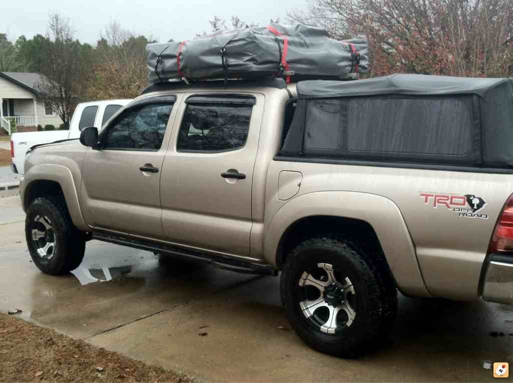

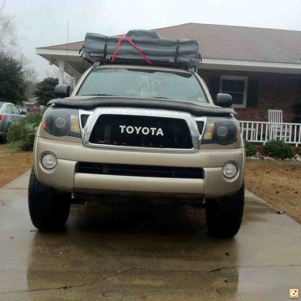

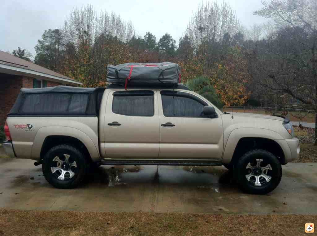

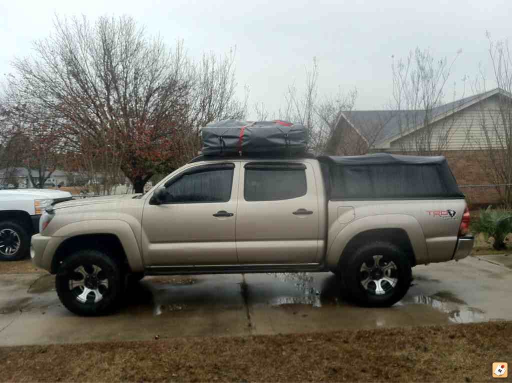

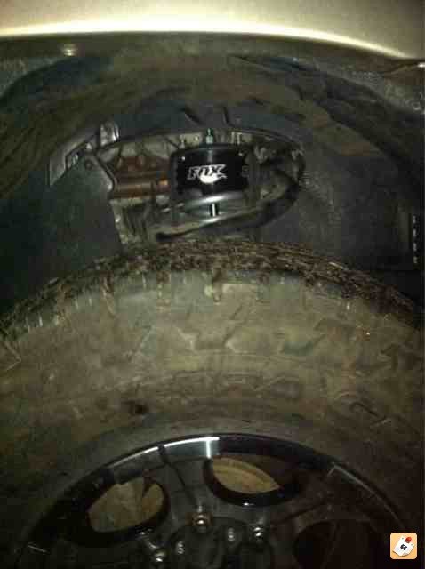

    Well last night me and chad(mainly me lol) after some curse words and busted hands we got the front lift on. It was super easy once we cut the damn sway bar off. The ride is freaking amazing. Way better IMO.
    And now the obligatory pics. I def have a bro lean at the moment.
    Measurements
    Front left: 22
    Front right: 23
    Rear right: 21.25
    Rear left: 21
    The bro lean is bigggg but it rides really well and I'm gonna check in a couple weeks to see where it settled at

    :eek: You cut it off?

    Yup... Didnt really need it and the truck rides a bit better to me.

    yea when I did my billies and stuff I had a really hard time.. we unbolted like half the front end to get them in... a lot of cuss words were said..

    Looks good

    that's supposed to be lifted???? :confused:

    i have the same foxes waiting to be installed on my truck, what do you think so far? I want to increase the hight another 1/2 to 3/4 of an inch how much of a PIA should it be? this is my first experience with coil overs.
