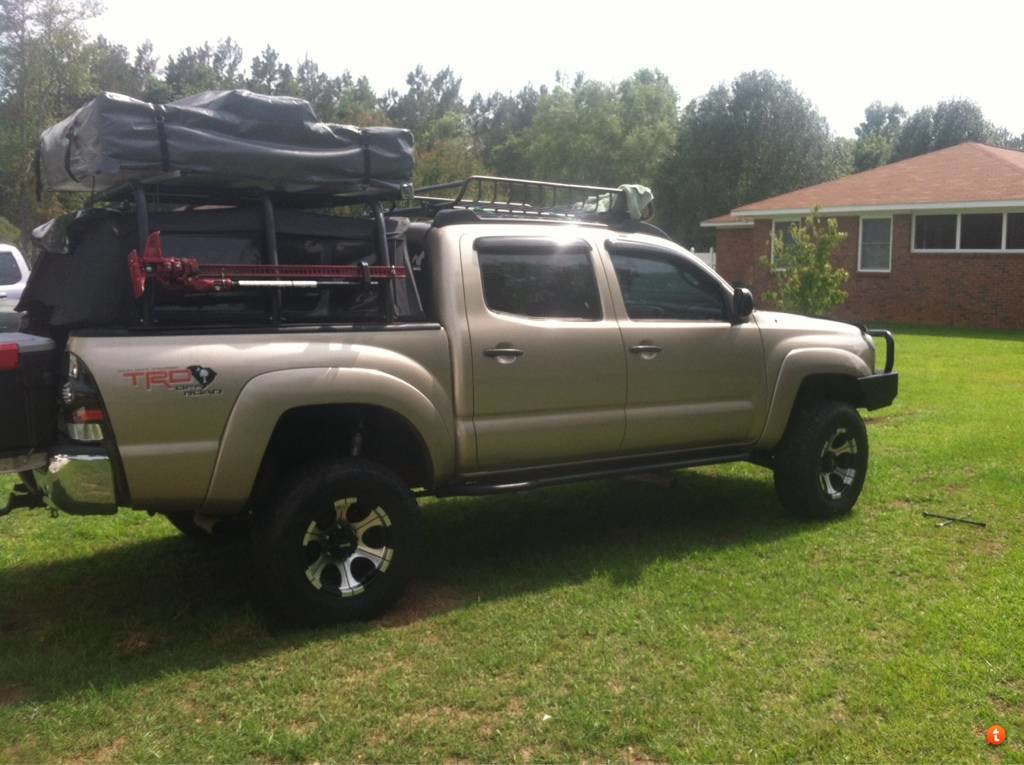

    One of the snazzier old man tan 2nd gens :cool: diggin that 82!
