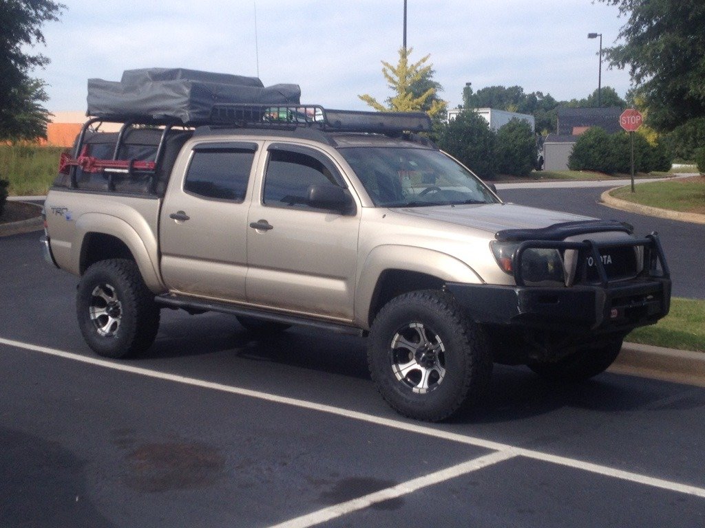

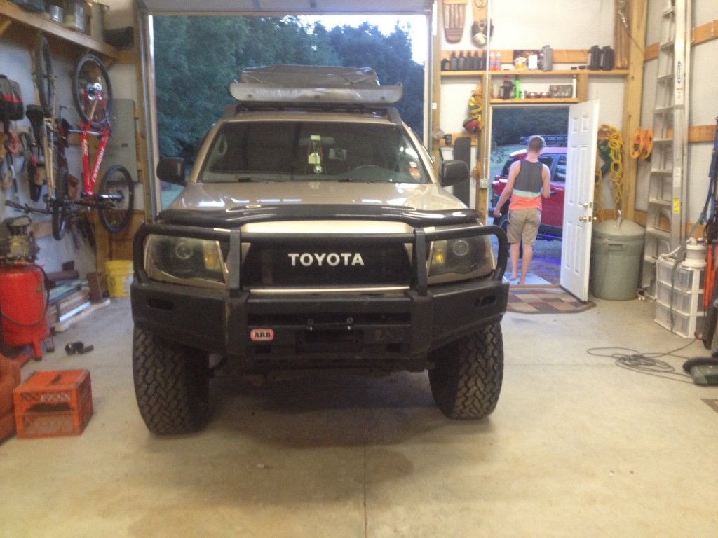

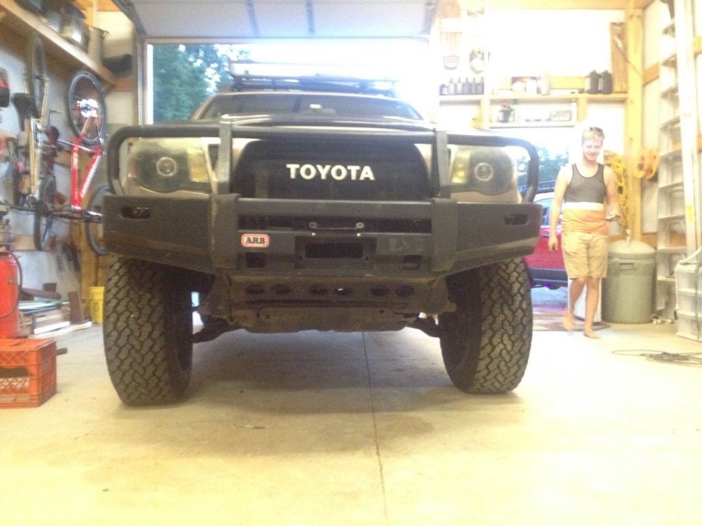

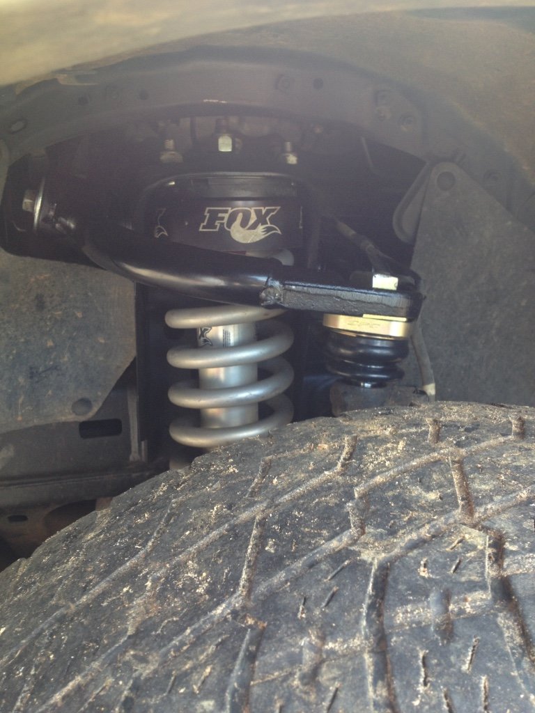

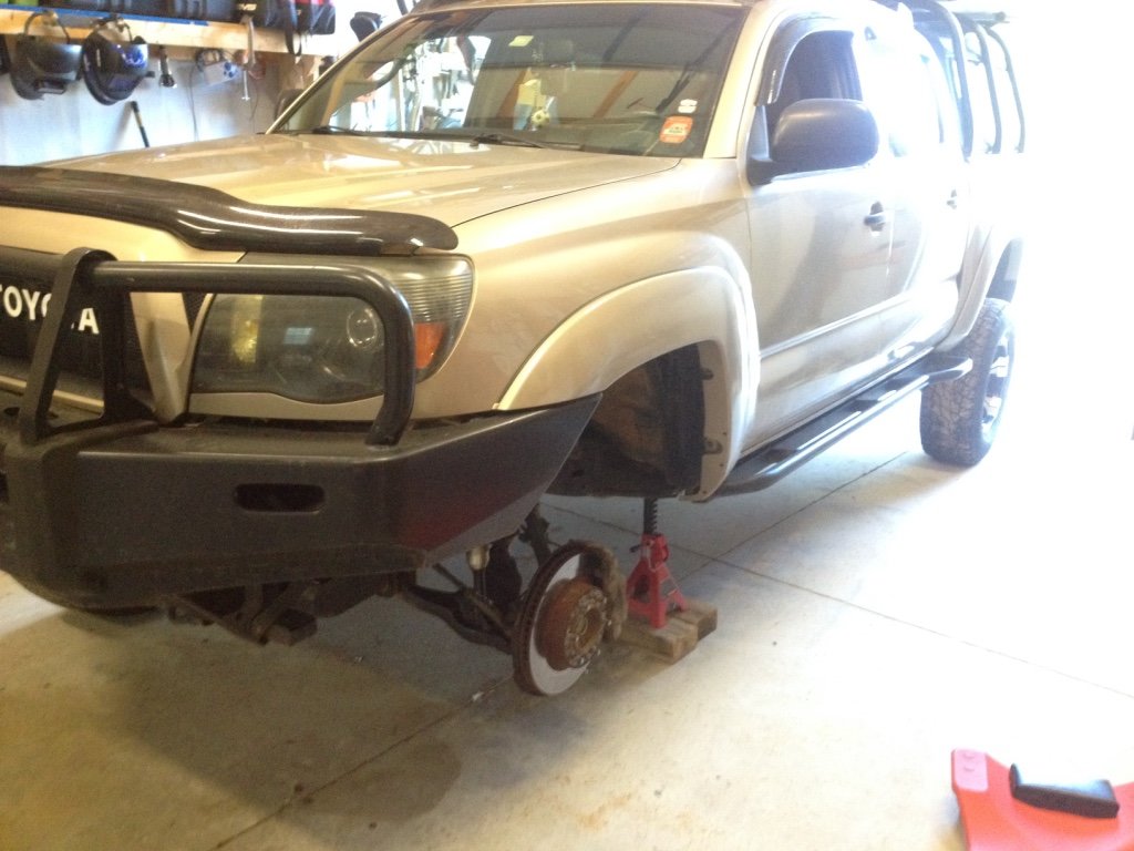

    Well the build got pretty involved these last couple days.

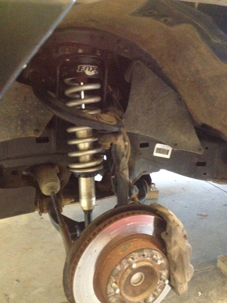

    It all started off by getting my LR UCAs on. The long bolt that holds the UCA in on the passenger side was a BITCH but we gots it done.
    Before
    After
    I also cranked up the Coilovers in preparation for the 285s
    Went to Discount Tire in Greenville,SC to get them mounted and balanced, also got their lifetime warrenty on the tires even though i didnt buy them from them so i thought that was pretty chill.
    Pics
    i had to trim this like a mofo.. couldnt turn without the sound D: :pout:

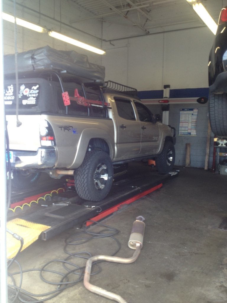

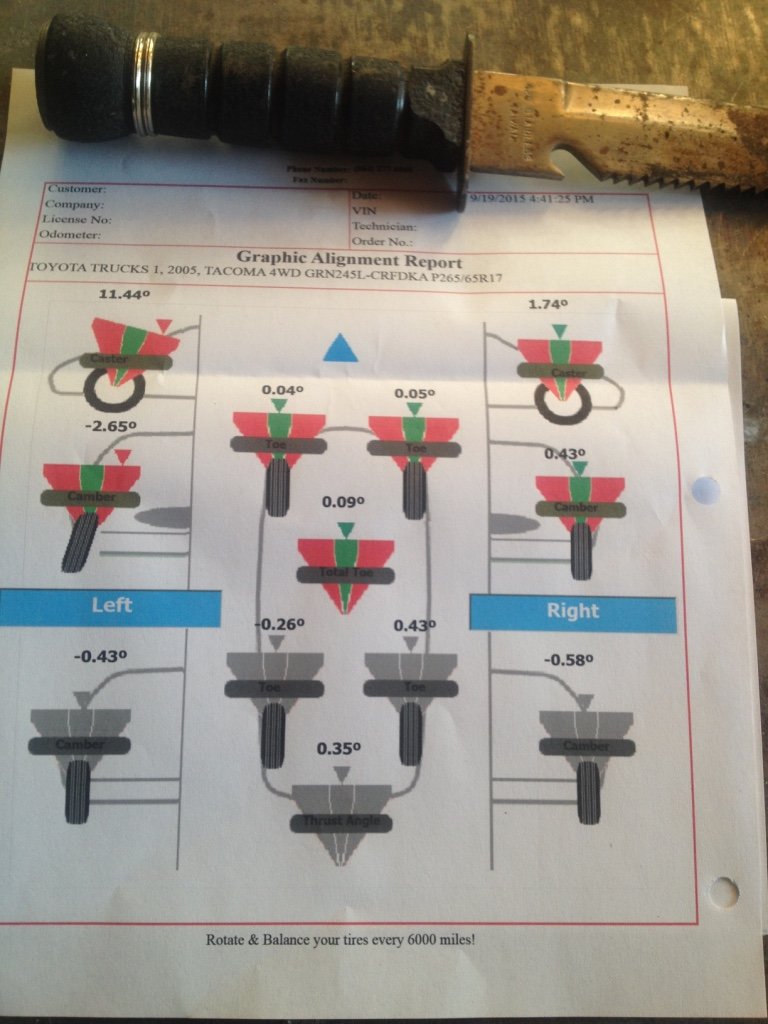

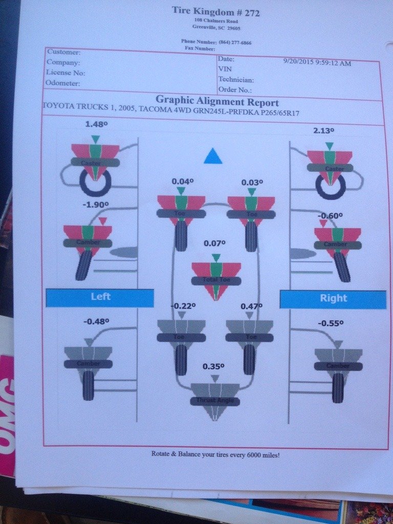

    Now here is where things get intresting. I gave the tech the sheet that explains how to adjust the UCAs, he didnt quite understand but winged it and this is what happened.
    11 freaking degrees.... :/ So i left and went back to my friends house so we could correct the caster on that side.. What do ya know he used an air tool and made it impossible to adjust the mofo(i sheared off some of the bolt using a giant wrench and a 6 foot long breaker bar :eek: :cool:
    So the following morning (today) i drove back to greenville and explained to him step by step how to do it. i wanted about 3+ caster because body rubbing problems.
    Overall i thought the algnment went well, there were a couple hiccups but it worked out.

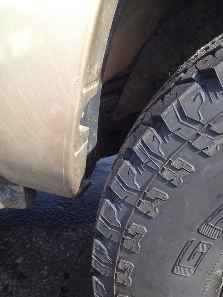

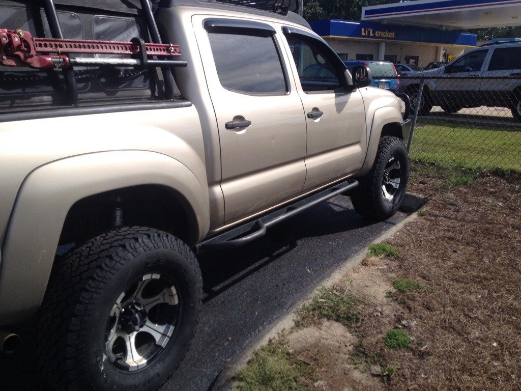

    Then the task of trimming for the 285's began. I got the fender to clear but the body mount is a serious concern(i want to go to Overland Expo in Asheville,NC next week and this needs to be fixed before i leave or im gonna have a bad time.
    Random pIcs. Im loving the 285s I can feel a loss in power but it's not that noticable to do anything about it at this point in time.

    looks good man :thumbsup: for cab mount chop i just picked up some flat steel from true value, and used pics as a reference of where to cut the mount at. then just make a rough outline on the steel and cut it to fit and weld it in.
    I was in a similar situation where i was going wheeling 3 days after i got my tires and didn't have time to get cab mount chop plates shipped.

    A+ Truck!! Doing everything the only way you should - The right way! Love the roof/bed rack setup.
    I just wanted to point out that alignment sheet. I was the 'alignment guy' at my local shop for years. That camber in the LF at -1.90 is a little much for my liking. You'll be fine as long as you rotate often. If you don't expect premature wear on the inside.

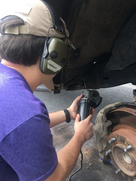

    Update time: Successfuly completed the Cab mount chop.
    Went to see my boi @Tlook in Clemson down the road so we could tackle it together (+ give him a package).
    It beginss
    @Tlook starting it off, we switched back and forth alot.
    Overall, it took about 2 hours. Im very happy with the results. No rubbing at full lock in reverse at all on the passenger.
    The drivers side.. it's like a 1/8" gap.. too close for comfort and at some point this week i'll trim the mount some more.
