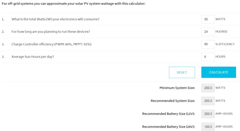

    @Sandman614
    The deep cycle ive already got in the bed is rated at 90. Is that gonna be good enough?
    scottalot likes this.

    It'll do. Really it comes down to will it be enough power when the sun is down for what you are trying to run.
    https://www.renogy.com/calculators/

    Based on what this site is saying and using super conservative efficiency numbers (~70%) im good with what ive got.
    Fridge only uses 50watts on average

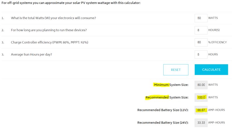

    So waht were you saying about your battery being dead and solar not keeping up?

    Im running a 20W solar panel.. lol the recommendation is at least 70 or better.. It cant keep up :(
    When i said i was good, i meant on the 90ah battery i have so far

    Yea, This says your battery is good but you need more solar panel, son

    Yeah ive got the 20W i was gonna buy a 100w and then just tie the two together and be done with it

    haha or more like this if you are gonna be parked and not running your truck/driving during the day.
