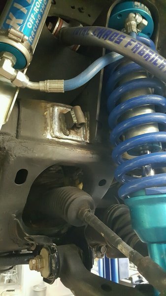

    How'd you bend the tabs? romping around or smashed on a rock? :spy:

    Definitely romping.

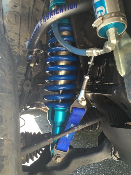

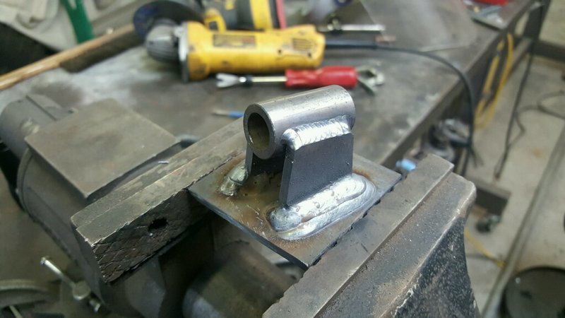

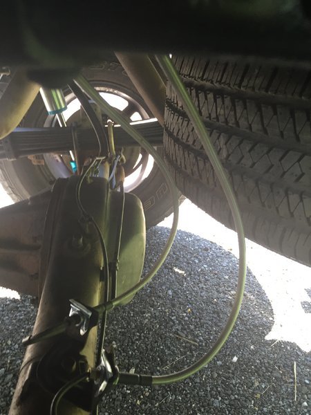

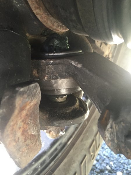

    Finally got some projects done. Limiting straps, extended front and rear brake lines, MOOG LBJs, and cam tab gussets. Performed all these at 122k miles. First time I've been able to get a good alignment in three years :/

    curious as to why you decided to get limiting straps on your truck? Were the Kings topping out? Mine top out and it feels like I need them. Running a pretty similar setup to yours with tc uca and king ext travel.
  5. Nov 7, 2018 at 8:17 AM
    #205
    NumNutz
    NumNutz [OP] One of the original 7928
    Jul 14, 2008
    #7928
    4,899
    Virginia Beach, VA
    07 Tacoma 4x4 - Kings, TC, Dakars, broken stuff
    Lots.
    I needed them because the UCA was hitting the coil before full droop. The other option there is to spin the coil itself till the coil is oriented in a way that prevents them touching, but honestly installing limiting straps was easier.
    I can't really recommend installing them where I did though. I think the limiting strap is hitting the inner tie rod boot. Short of installing new LCAs which I didn't want to do that was the best option.

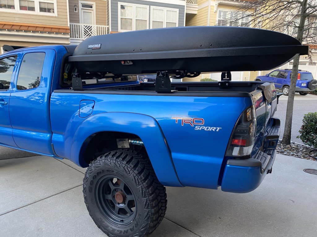

    Just had the front wheel bearing both driver and passenger side done. Then installed a set of new-to-me VooDoo Aluminum Hi Rise Crossbars with my Yakima Rocketbox. I've always loved this look and never had a way to mount it well. Pretty pumped with how it looks.
