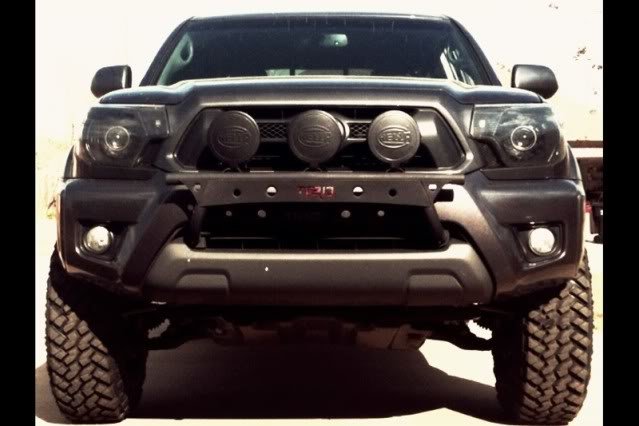

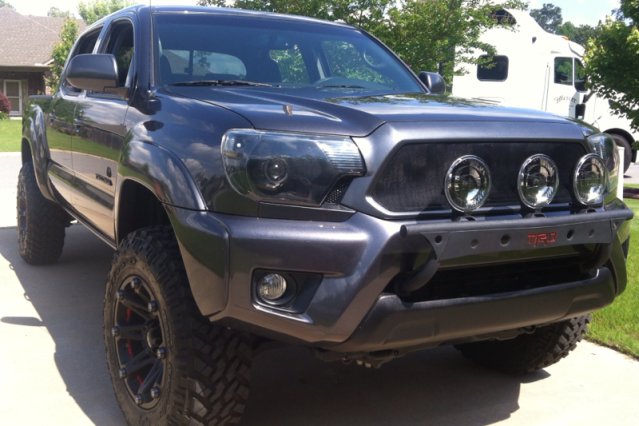

    The width of your tire plays a much smaller role in the stance of your truck than the backspacing of your wheels.
    I'm running 255/75/17s on a 17x9 -12 offset (4.5 backspace) wheel and my tires stick out about 1.5 inches outside my fenders.
    Same pic as my sig in case you are on the mobile version of TW

    With the wheels straight there is about 2.5 inches. At full lock there's about 1.25 inches from the tire to the fender liner. The only time I've been able to make it to rub was when I turned into my driveway at full lock and pretty fast (I was trying to get it to rub) I haven't had any rubbing during normal driving on the road. Offroad all of my driving is at low speeds so I haven't had any issues with rubbing there either.
    Before i took them off it was rubbing bad on the small flaps on the front of the fenders.
