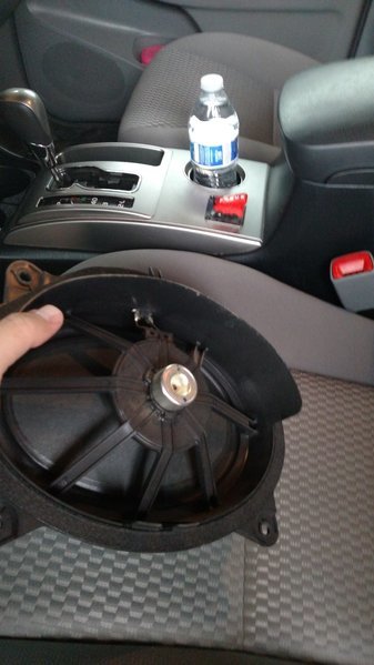

    Here's the stock 6x9 or of my door. Upgrade from this pos before spending$ on anything else. That might be all the sound you need after you hear the difference.
