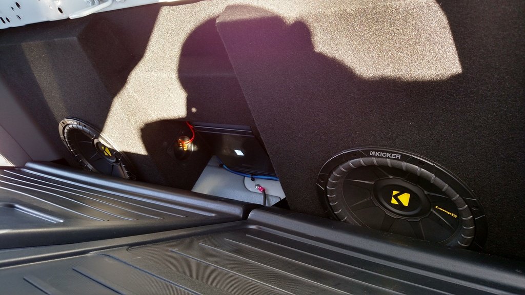

    I went to Amazon.com and bought this custom box for the DC Tacoma
    Then I had the local shop install some Kicker Comp D 10" subs and an Alpine amp. Thumps pretty decent. Way cheaper than *********.
    Would still like better door speakers at some point though.

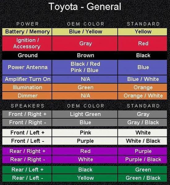

    This was the most useful piece of info for me
