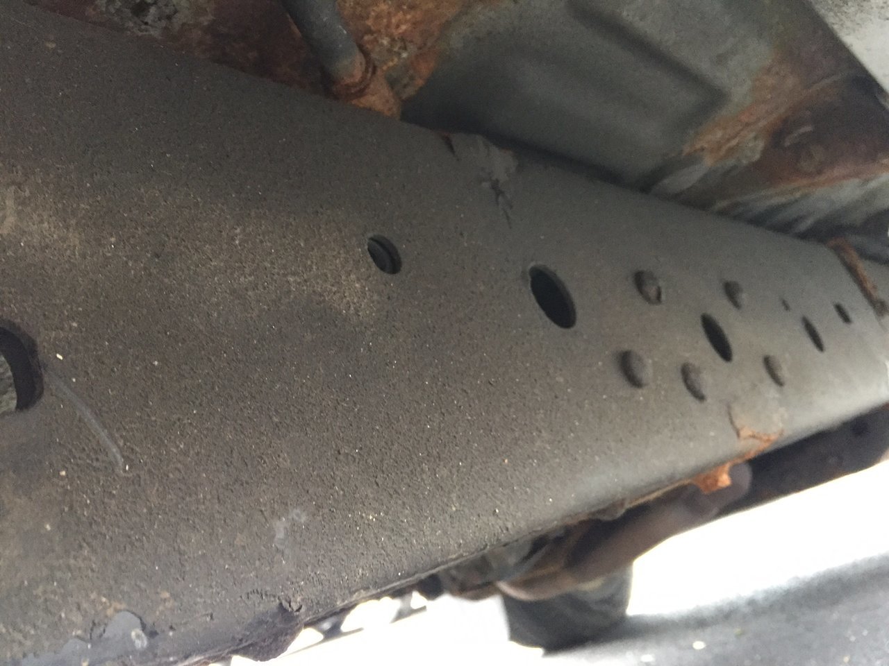

    I also asked for an undercarriage pic:
    The autocheck seems fine and there is a 60 day warranty (not that I'd hang my hat on it). I figure I can get it for about $10.6k.
    I haven't seen it in person yet, but looks pretty clean and a decent price.

    Only concern is it looks like the body is rusted?

    I think it wouldn't hurt to check it out, but when you go get under the vehicle and check that frame out. Take your fingernail and try to see if any big pieces fall off, especially by the catalytic converter. Here's a thread on rusted frames issue "where's them rusted frames" most all of these issues are in your neck of the woods. So I would be extra cautious and the extended warranty protection from Toyota only applies to those that have owned the vehicle since December 2015. Toyota frame settlement postcard

    The frame looks coated, and that it may be hiding potential rust. Read that rust thread and find the problem areas, and bring a hammer and tap the frame in those areas. If the frame is solid, it looks like a good buy.

    The guy has come down to $10.6k already (plus tax, tags, etc). It's really tempting, but the undercarriage pics are worriesome. I agree it looks coated and I don't know enough about cars to trust myself in testing it out.

    Do you have a local garage that you trust that would do an inspection before you buy it? That undercarriage would make me a little nervous....Maybe cost you a few bucks for peace of mind

    You can see a decent amount of underbody rust. It also appears that some type of coating was applied over rust on the frame. For me its a rust thing, Miles and all the rest are moot if it will fold in half in 3 years.
