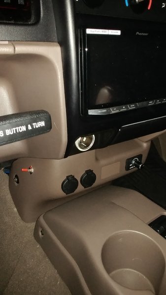

    Jeff
    This is what my installer did by using a small micro switch (red one visible on l/ side of console ) so I can watch videos while driving . The micro bypass didn't work so we opted for a small micro switch , if anyone asks what that switch I just tell them that a nitrous arming switch LOL !!!

    With the bypass installed and e brake off it wouldn't allow access to the video screen menu and it wired correctly
    We then tried the micro switch and that allowed access to the video menu with the e brake off . also the switch is mounted to one of the screw holes so nothing was drilled and can easily be relocated if need be
    I was thinking of putting the switch next to the bass volume control but decided against that
