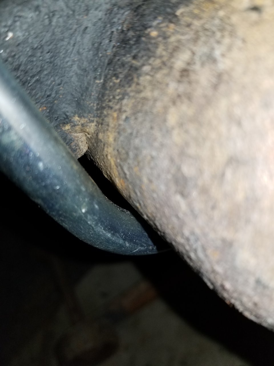

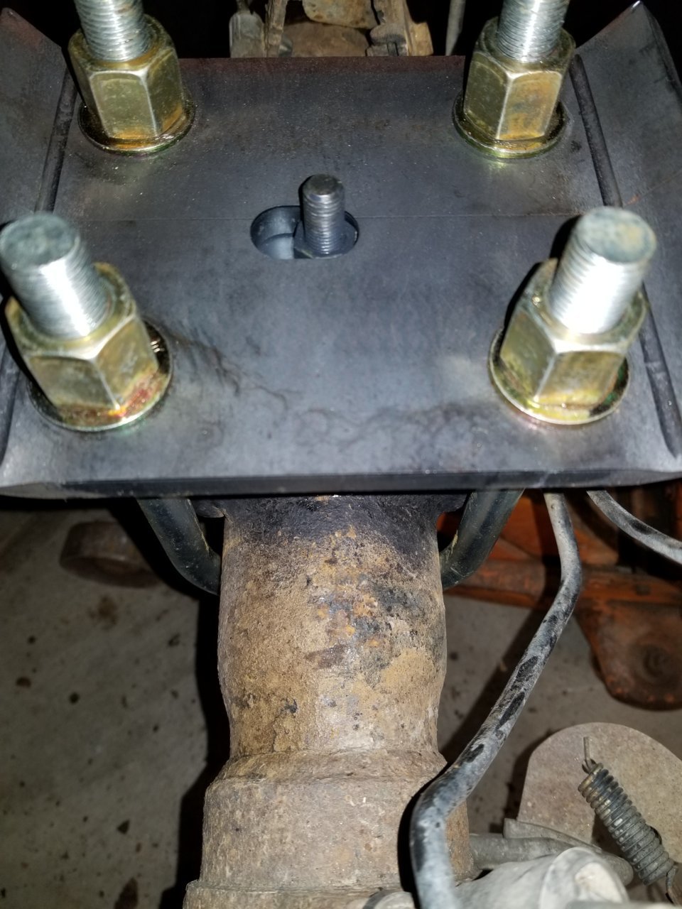

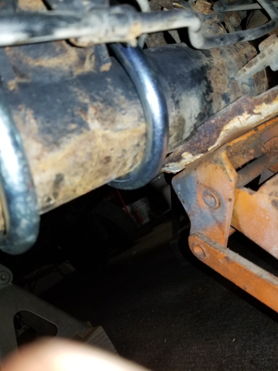

    Bought a Marlin Crawler u-bolt flip kit and started the install today. Got the u-bolts on one side and they look a little wide. Axle tube is 3" and the u-bolts are 3.3" (to the inside of the bolt diameters). Pretty sure these are supposed to fit snug. Opinions? Thanks
    Photos attached.

    too wide i wouldent run them i would find u bolts that fit.

    Agree too wide, will the plate support 3" ubolts? Or will you have to auger it out?

    That's what i figured. I will have to open the plates up a bit or return the kit and get something else. Darn

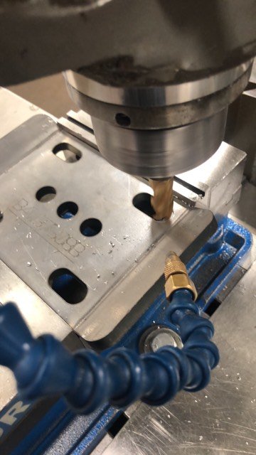

    I guess it depends on how big the nut is but it cleared the nut in my spring pack fine. It could always be drilled bigger if need be, i had to machine mine out the slots to accept a u-bolt that was slightly bigger than the plate would accept when i did my axle swap.

    Seems like everyone so far has agreed, but that's how my ubolts look and I've had no problems.
    They shifted around a bit until I really cranked down on the nuts, but I've banged it around offroad a LOT since then.

    Little update. I emailed Marlin on monday but haven't gotten a response yet. After some extensive searching it looks like this is pretty normal for this kit and similar kits to have oversized u-bolts (by about a 1/4"). I'm not comfortable running the oversized bolts so I will be going with the barnes plates and 3" u-bolts suggested by @agalloch07
