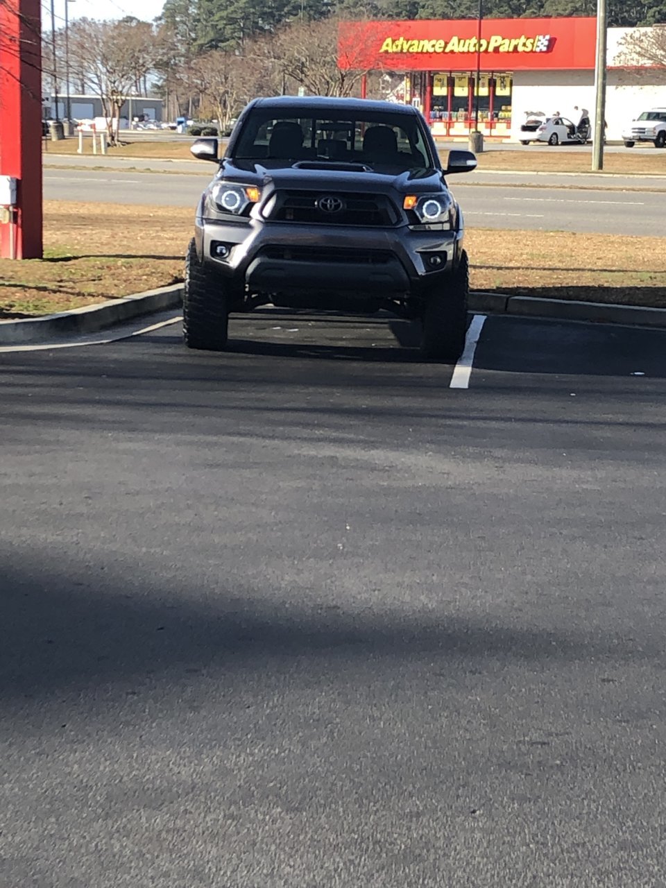

    What are your opinions on these headlights? Has anybody tried them?
    Pros and cons.[​IMG] [​IMG]

    Not seeing the image...
    Maybe post a link.

    Whatever high production aftermarket headlights, it's not going to compare to oem. Just make sure to run a bead of silicone around the seal whichever headlight you choose to lessen the chance of moisture or water intrusion.

    DIY retrofit. YouTube is your friend. Very easy job and total cost will be less than $500. Don’t let these retrofitters beat you over the head with outrageous prices. I just finished my first set. Turned out better than the person I had retrofit my first set, at half the price

    Any aftermarket headlight will be a downgrade from stock in performance and durability. Best headlight upgrade option is to use the OEM TRD smoked chrome headlights that came on the Pros. Part numbers, links with good prices to purchase and how to mod the headlights for a massive increase in output are covered below:
    https://www.tacomaworld.com/threads/the-ultimate-headlight-upgrade-h4-not-led-or-hid.398066/
