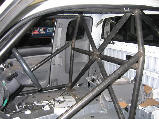

    Yes, unless you majorly violate the cab an exo cage will not be as strong as an internal cage because you can't triangulate like you would internally.
    Generally exo cage = rock crawler (where you are more likely to roll but it is also going to be a low speed flop) and internal cage = go fast vehicle, where you are less likely to roll but when you do it is more likely to be catastrophic.

    Your thinking triagles in just one direction, it has to go in all directions. He meant violating the cab to insert tubes through it, otherwise you just have cab hoops. These are the tubes he is talking about that are needed, they would be going through the cab to connect the "hoops"
