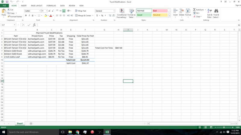

    Hello all! I have been debating on what parts I want to use to get my taco a little bit more off road ready. I believe that I have finally settled on the bare essentials, but due to the face that I am new to the game on modifications I would like some opinions on the parts that I'm thinking of.
    First comes the front suspension. as you would expect, Bilstein 5100's with stock coils (for now)
    http://tinyurl.com/gkpjkkd
    I don't think there will be much debating on that decision.
    Onto the rear. A 2 inch Tuff Country Add-a-Leaf. I am aware that a progressive AAL would have a better ride, I just don't have that kind of money.
    http://tinyurl.com/z8lmunb
    Finally onto the tires, I have decided on 285/75R16 BF Goodrich All-Terrain T/A KO2 tires on the stock steel wheels (Once again for now)
    http://tinyurl.com/julyhsh
    I made a spreadsheet to show the prices of everything, just for shits and giggles

    I don't see any labor in your spread sheet or a cost for mount and balance of tires.
    But I do see a split cost line. Santa goes help out??

    I plan on doing the work myself. as to the mount and balance. I have a connection at the local tire shop that can do them for next to nothing.
    And yes I am hoping to have a little help from my parents, a thousand dollars is a thousand dollars, I'll take all the help I can get.

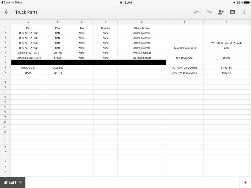

    image.jpg I have updated my spreadsheet, with prices from the local tire shop. $210 out the door, mounted, ballenced, and installed. Went down to 265/75r16 the price is slightly cheaper now. And the tires come with a nationwide roadside assistance, and free rotation at any "tire pros" location
