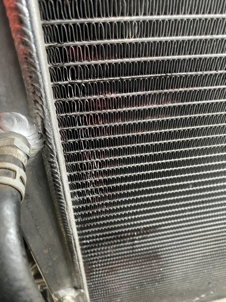

    For whatever it’s worth
    my 150$ one after a few years

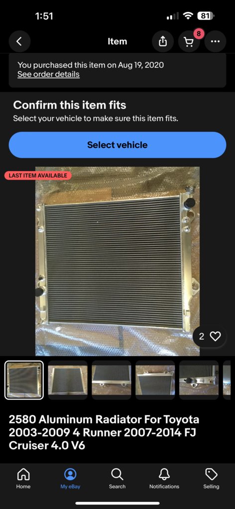

    THAT is EXACTLY what I am looking for. Can you share the part number and source?
