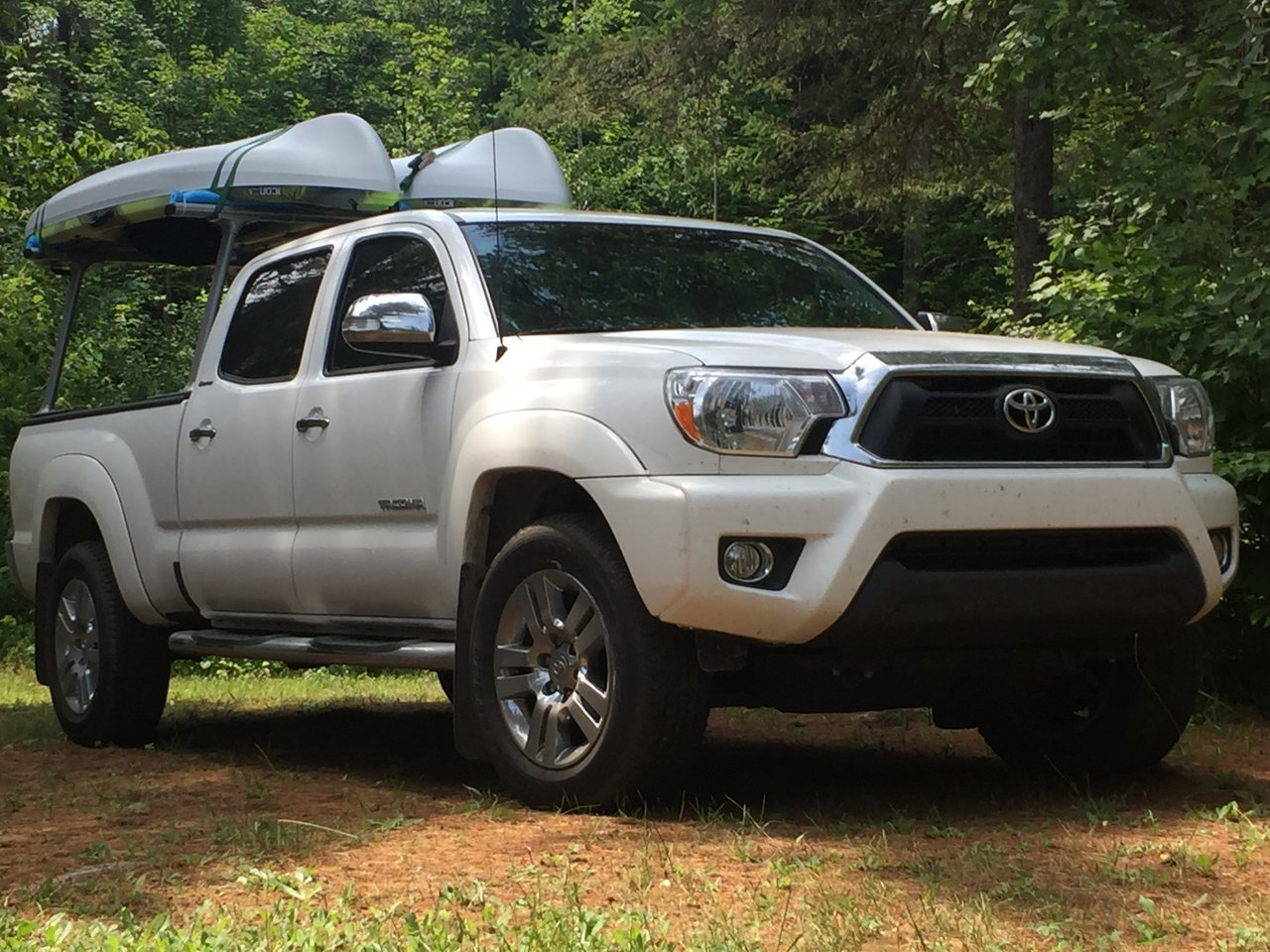

    Whatever kayaks you get make sure the roof rack is wide enough to accommodate them laying flat.
    I have 2 10’ fishing kayaks and I use TracRac with 65” crossbars to transport them flat.

    Here is one and also checkout this thread
