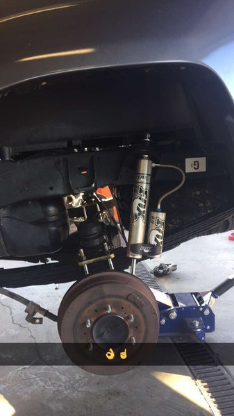

  7. Jan 16, 2017 at 5:13 PM

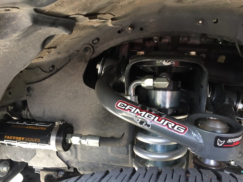

    OP i am running fox 2.5 with camburg UCA in front and fox 2.0 in rear with allpro standard leafs and timbren bumps. I have about 20k on the front suspension and 15k on the rear. No issues and it rides great off road. Also for your uca's they have kits to replace worn bushings or the uniball itself.

  13. Jan 16, 2017 at 5:37 PM

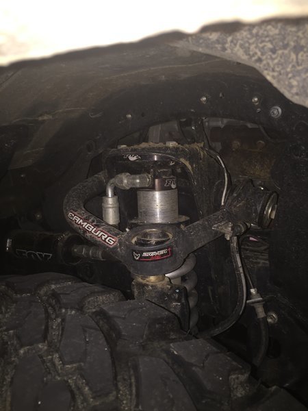

    4WD FTW[OP] likes this.

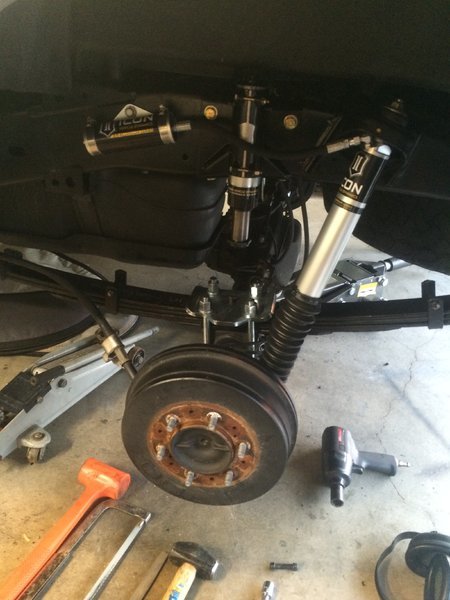

    IMG_1212.jpg IMG_1214.jpg I have icon/ total chaos stuff on mine and it's great thus far. Too good of a deal to pass up. I'd say king, fox and icon are all right in the same ballpark. UCA's are completely serviceable.

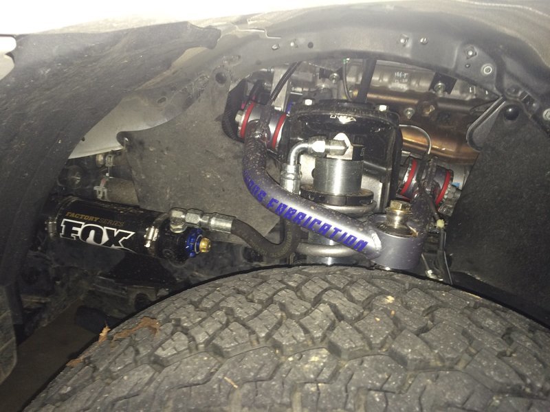

    Check with Marie @HeadStrong Off-Road. That is very close to the setup I'm running (fox extended travel 2.5, LR UCAs, fox 2.0 rear, Dakar leaf pack, swaybar delete).
    Make sure you get the extended travel coilovers and the rear shocks need to be proper length for the new springs...not sure how an AAL now then converting to deavers later will impact things when it comes to selecting the right shock length but I know the Dakar springs gave me a lot more droop. Marie was very knowledgeable and their prices are great (free shipping FTW).

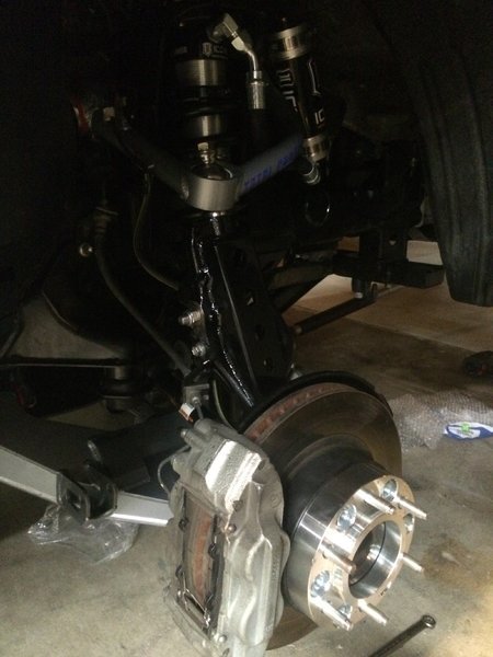

    I like how Icon's coils come already black and they don't seem to be run as often. Would be nice to have a more unique setup.
