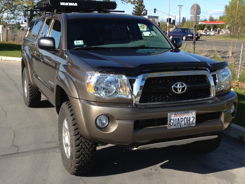

    AprilTaco2_8c48baacad8424506e686c479c978062eb03e820.jpgCap.
    I too had a custom built top with a reinforced roof rated at roughly 400 lbs with tracks installed at the factory. My cap is the Snugtop XV. Rack system is Yakima. Have carried lots up there including 2 kayaks; 1 kayak and bike; camp gear; ice chests; tire; fuel; dead deer; etc..

    GuapOh, are you lifted at all? Can't tell if that's a 2" lift of stock.
