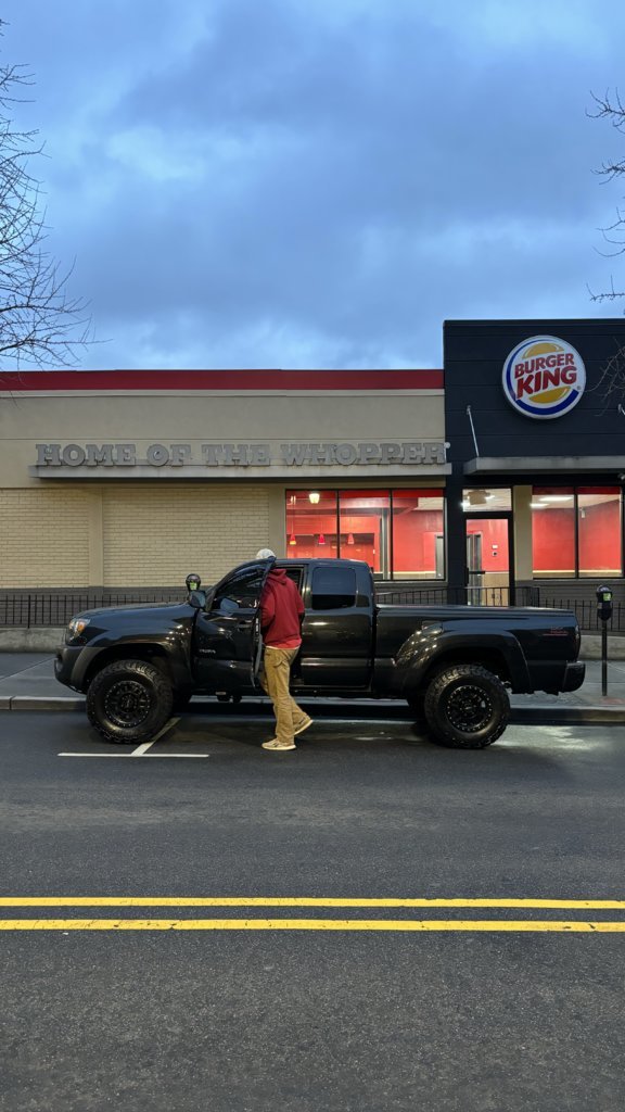

    Hey guys, I’d like to start by saying I have seen various threads on the forum about upgrading 2nd gen tacomas suspension. Some of them suggesting that’s the 3rd gen suspension paired with 2nd gen springs and others suggest OME and the Dakar leaf springs. However, I am looking for some recommendations for what I am looking for in particular. In the past I was looking for some lift when I had a 1st gen Tacoma. I settled for bilstein 5100s set up at about 2.5” lift. My experience with this at this amount of lift was a rough ride as well as going through CV axles like nothing.
    Nowadays I’m looking for something that is somewhat in the sweet spot. I would like about and inch or so of lift as to not put too much wear on any front end components but allow enough space for my 31 inch tires. I would also like something that gives a bit of a smoother ride (I know it won’t feel like I’m riding on a cloud but at least a little smoother) but also handles well in corners. Anything should be better than my current setup (the suspension is best to death to the point the rear leaf pack is frowning).
    The truck is currently at 220,000 on the odometer. It is my daily driver. I would basically like to do a full suspension upgrade. This would consist of shocks/struts, coil overs, leaf pack, and UCAs. Not sure if anything else would be necessary to improve the ride. Any suggestions for suspension upgrades would be appreciated as well as links to threads I may not have read yet.
    What I am looking for out of the suspension:
    smoother ride on the road. Living in New Jersey I normally encounter streets where several blocks are just made of of a bunch of potholes.
    for off-road it’s occasional. Pine barrens sand roads or dirt roads sometimes with the speed bumps sometimes without.
    towing I don’t do much of as of right now. Usually just bed loads for work tools and materials as well as occasional heavy loads for landscaping materials.
    right now my wheels have the proper offset as to not rub. I have BFG AT KO3s 265/75r16. I understand since these tires are rated E the ride is already going to be tougher. However, I am a big fan of these tires handle great on and off road as well as all weather conditions. They can also take a beating.
    and in terms of looks a bit of stance. The current stance I have I like. About an inch over stocks but it’s a spacer lift.

    I appreciate your help so far. I will edit the initial post to explain what I’d like out of it on all roads.

    @TomHGZ The UCAs aren’t for smoothing the ride but more for my safety. The car is at 220,000 miles with a lot of wear on many components. The ball joints are definitely shot on the UCAs. Also if I set the ride height at 1”-1.5” I’d like to be able to account for that with the UCAs.
